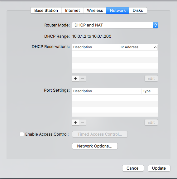

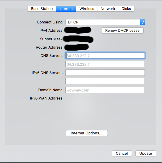

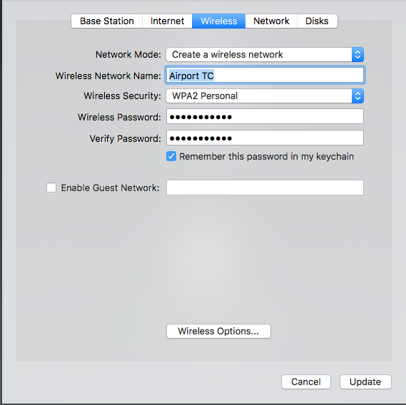

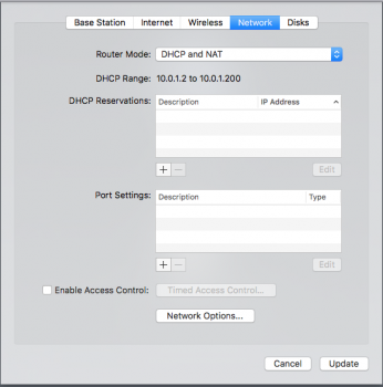

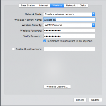

[doublepost=1522719957][/doublepost]Here are my current settings for my AEBS. I have no other network equipment and the AEBS is connected with a wire directly and broadcasts the Wifi to the house. All iphones, ipads, laptops, xbox and Imac all connect via wifi
[doublepost=1522720203][/doublepost] Screen Shot 2018-04-02 at 9.44.07 PM.png Screen Shot 2018-04-02 at 9.43.58 PM.png Screen Shot 2018-04-02 at 9.43.51 PM.png
I would move the modem upstairs along with the Extreme. The extreme has better throughput than the Express. The settings should be fine as is for the router (Extreme), and the Express would be set to extend the network, allowing it to connect wirelessly to the Extreme. Make sure the Express is placed somewhere that gets a solid signal to the Extreme.
Again, think about making the 5Ghz SSID slightly different, Airport 5G for example (Wireless Options). Then, on all devices that can connect to 5Ghz, join the 5G SSID and "forget" the Airport TC network. If any device has issues with 5Ghz (due to range for example), join the 2.4 SSID and keep both in the settings on that device. The effect of limiting a device to the 5Ghz network is that it avoids the issues with interference on 2.4Ghz, not to mention the 5Ghz signal is likely 802.11ac which is much faster (up to 1300Mbps) than the 150-450Mbps of the 2.4Ghz under ideal conditions. Further, by reducing the number of devices on 2.4, there is more capacity for those devices that can't connect to 5Ghz.
But, again, expect some WiFi speed hits due to the second access point (Express). Since your ISP is 100\10, this should not be an issue other than slowing things a bit with file transfers between devices on the WiFi (iMac to xBox for example).
If WiFi speeds suffer too much (due to the radios sharing backhaul and client traffic), consider Powerline or MOCA to make the connection to the downstairs Express hardwired. You may not need to do this at all if the signal between units is strong.

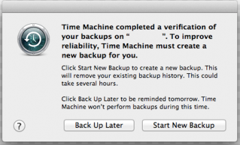

I wish that was the case but I keep getting this type of error message and what I have read online is that perhaps it would work better if the iMac was directly connected to the AEBS

First things first, delete the old backup and start a fresh one. No matter how good your connection is, you may not be able to recover from this condition. Unless you really need old backups, a fresh start may be in order.
