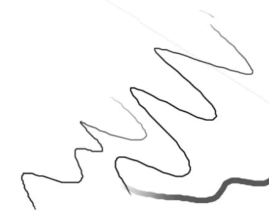

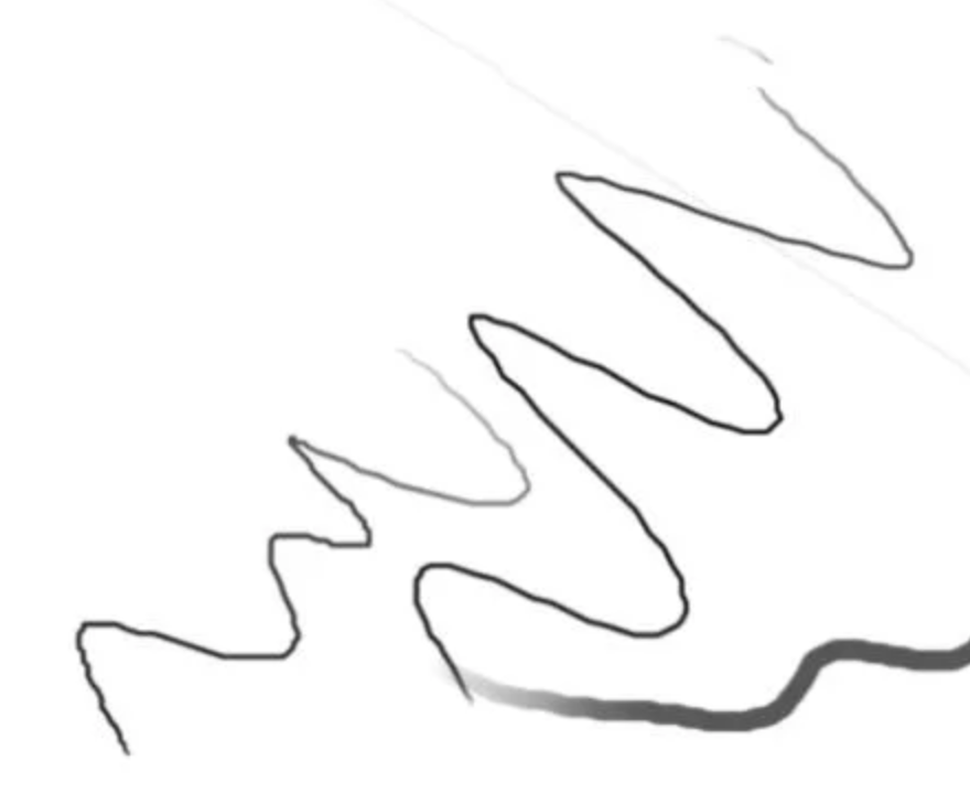

Here is an example (found it on reddit):
The general trajectory of the line is as intended but the line itself isn't straight. If you zoom a bit you will notice the small waves.
