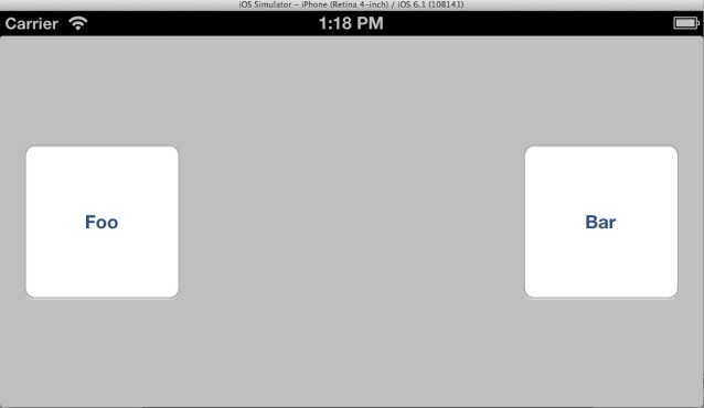

Figure 1: how I have laid out my nib

@property (strong, nonatomic) IBOutlet UIView *portrait;
@property (strong, nonatomic) IBOutlet UIView *landscape;
@property (strong, nonatomic) IBOutletCollection(UIButton) NSArray *foos;
@property (strong, nonatomic) IBOutletCollection(UIButton) NSArray *bars;
- (IBAction)buttonTapped:(UIButton *)sender;
@end

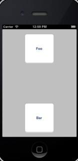

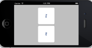

here is what the output looks like; When the app starts out , its correct exactly how it looks in the nib portrait view, but when you rotate it it looks like the second pic.
Question 1:
Since I have laid out the Landscape view in the nib file; how come it does not look like that when I rotate the device??

Question 2:
Why do we have to set the value of self.view.transform to CGAffineTransformIdentity? Why cant we just call self.view.transform = CGAffineTransformMakeRotation(degreesToRadians(-90));?
Question 3:
Why do we need to set the bounds? Again we specified this view in the nib
Question 4:
For debug purposes I created to CGRects as you can see and looked at their output. The bound value is just as I put them to be in my code, but the CGRect for Landscame_frame which is the origin and dimensions of the landscape view with respect to its super view is landscape_frame = origin=(x=20, y=0) size=(width=300, height=568. Where is the (0,0) point of a device in landscape mode? I dont get the (x=20,y=0).
Question 5:
Why is the frame size (width=300, height=568) ??? Hows the width of the fram 300???
landscape_frame = origin=(x=20, y=0) size=(width=300, height=568)
landscape_bound = origin=(x=0, y=0) size=(width=568, height=300)
