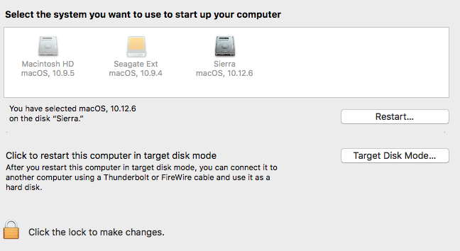

Hi again
Yes, as per pic.
Mitch
According to this, you are booting into Sierra on reboots, as you stated
Can you click on the lock at the bottom, enter your Admin password and select the Macintosh HD icon and try to restart?
Yes, that worked fine - it launched into Mavericks ... what do I need to do to have the option of which OS to use on startup (i.e. if I come back to the machine the next day?)
