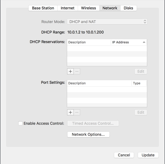

Not quite that simple. TC is a router by default, you don't want 2 routers.
Go into Airport Utility and edit the Time Capsule. Make sure Router Mode is set to Off (Bridged Mode) on the network tab. If you don't want the TC to prove WiFi, set Network Mode to Off on the Wireless tab. Update, and when it is rebooting, connect an Ethernet cable from WAN on TC to a LAN port on your new router.

[doublepost=1517758236][/doublepost]Just acessed the network tab but it is not allowing me to select the router mode tab. It's greyed out and I don't know how to enable it.
I've worked out why I cannot access this menu.
On the Internet tab I have selected Connect Using: PPPoE
Changing this to Static or DHCP allows access to the Router Mode field.
If you had any critical networking options (DHCP reservations, Port forwarding etc.) on the previous network those will have to be reconfigured.
