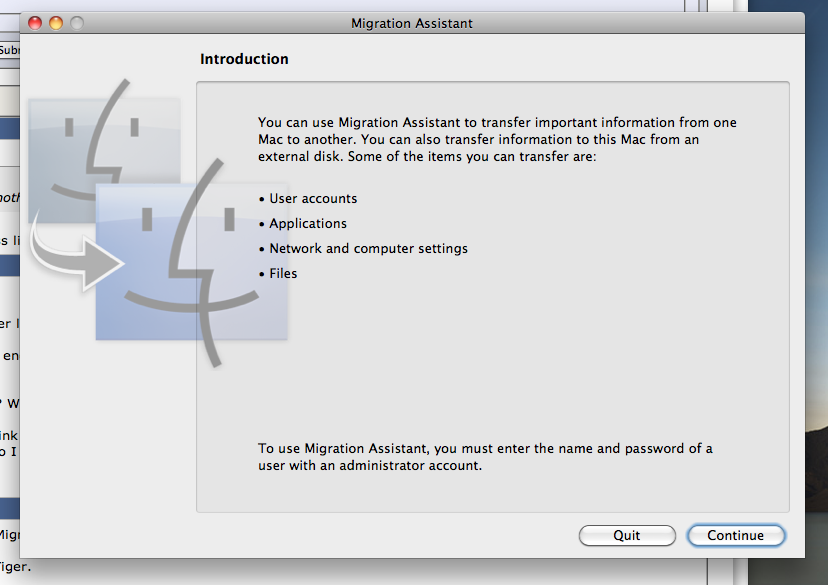

My solution is you hook up the external drive.
Launch Migration Assistant.
Point it at your external, and tell it what you want to copy.
It will move everything over for you and give you a user account on the new Mac Pro with everything from your system/boot drive.
It will be like you have a new Mac, with all your old stuff moved over.

Cynicalone - I don't want to permanently change the newer Mac because its not mine. It has go back to its previous state after I'm gone.
