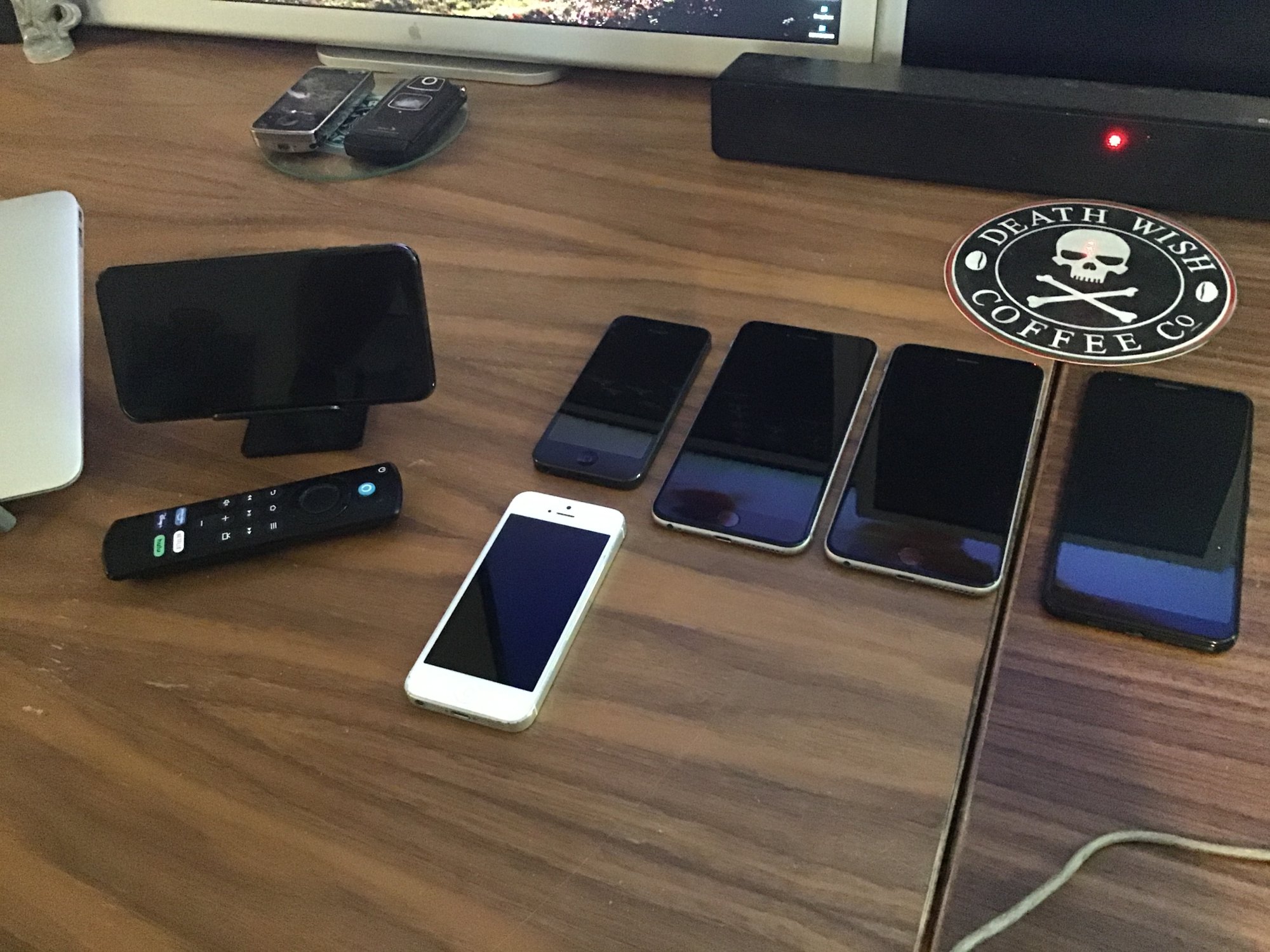

Below is my phone history from 2007 to today (the white iPhone 5 was my wife's). When a device of mine switches from primary to secondary and then beyond that, financial apps are removed (they aren't needed and won't function on old iOS versions). Based on whatever I use them for, I may still maintain older versions of apps (such as Dropbox) and I do keep them on FindMy.

Eventually, these are going to stop functioning - at which point they become display items on my tech shelves. There's always a danger of course that someone could break in, steal these phones, scavenge them and get some of my private data off them of course. But that's going a very long way for theft of opportunity.
With regards to battery swelling, you can see the two iPhone 5s I referred to earlier. Considering that I have phones back to 2007 (with many of them still working) it just really isn't an issue to wait for me. 🙂
PS. Not seen in this pic is a 3GS, a 4 and a 4S. But neither of those three phones were ever a primary phone for me.

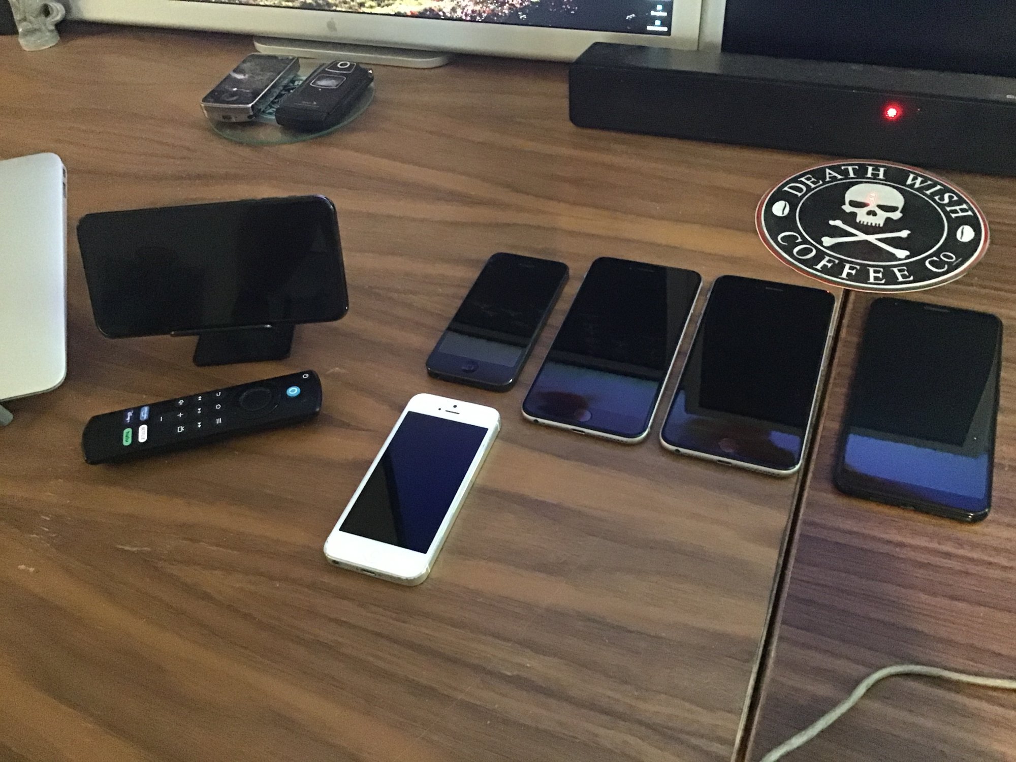

Love it! I’ve kept (almost) all of mine all this time as well, from my first iPhone (8 gig version, the mid cycle update, while my late husband had the very first generation 4 gig) and first gen iPad, all the way up to the current ones. My iPhone 4 is still jailbroken…and let me tell you, I still miss both the functionality I added to that device and the custom icons. Up until now, everything still worked, though figuring out where I hid my 30 pin cables is sometimes a challenge.
But at some point I started to feel that really cool clutter is still, well, clutter. I gifted a working Macintosh Plus to a young woman earlier this year because she badly wanted to hack around with one…it was probably a good 15 years older than she is. I *may* keep the 4 and my first iPad for now, and I’ll certainly make sure there’s nothing in the way of critical data on them, but for the most part, I think I’ll send the rest on their way.
