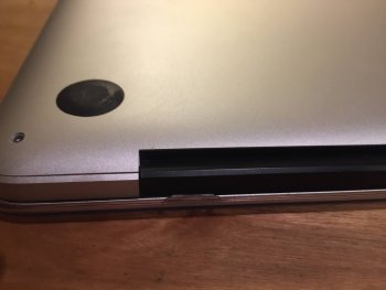

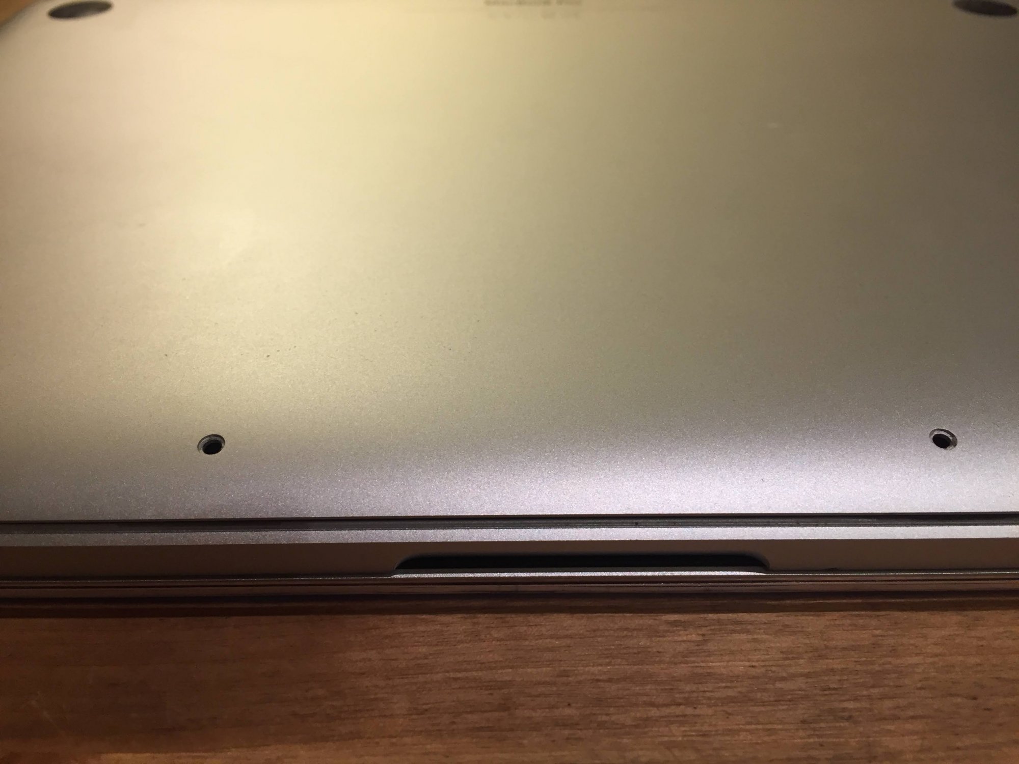

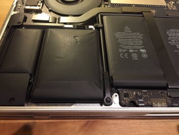

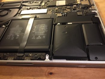

Here's the photos. You can see that the case struggles to adhere in the lower part, but the upper part seems fine.
And the battery inside, left side, and right side. I believe that the part in the middle looks fine, the parts on the sides look a bit swollen.
What's your opinion?
Thanks

The battery is swollen and dangerous.
In addition to damaging the trackpad (likely) and damaging the keyboard (less likely) it can also deform the top and bottom case; a colleague let his 15" inflate fully and ended up having to replace the top and bottom case - about £300 from Apple instead of £200 for a battery/top case
