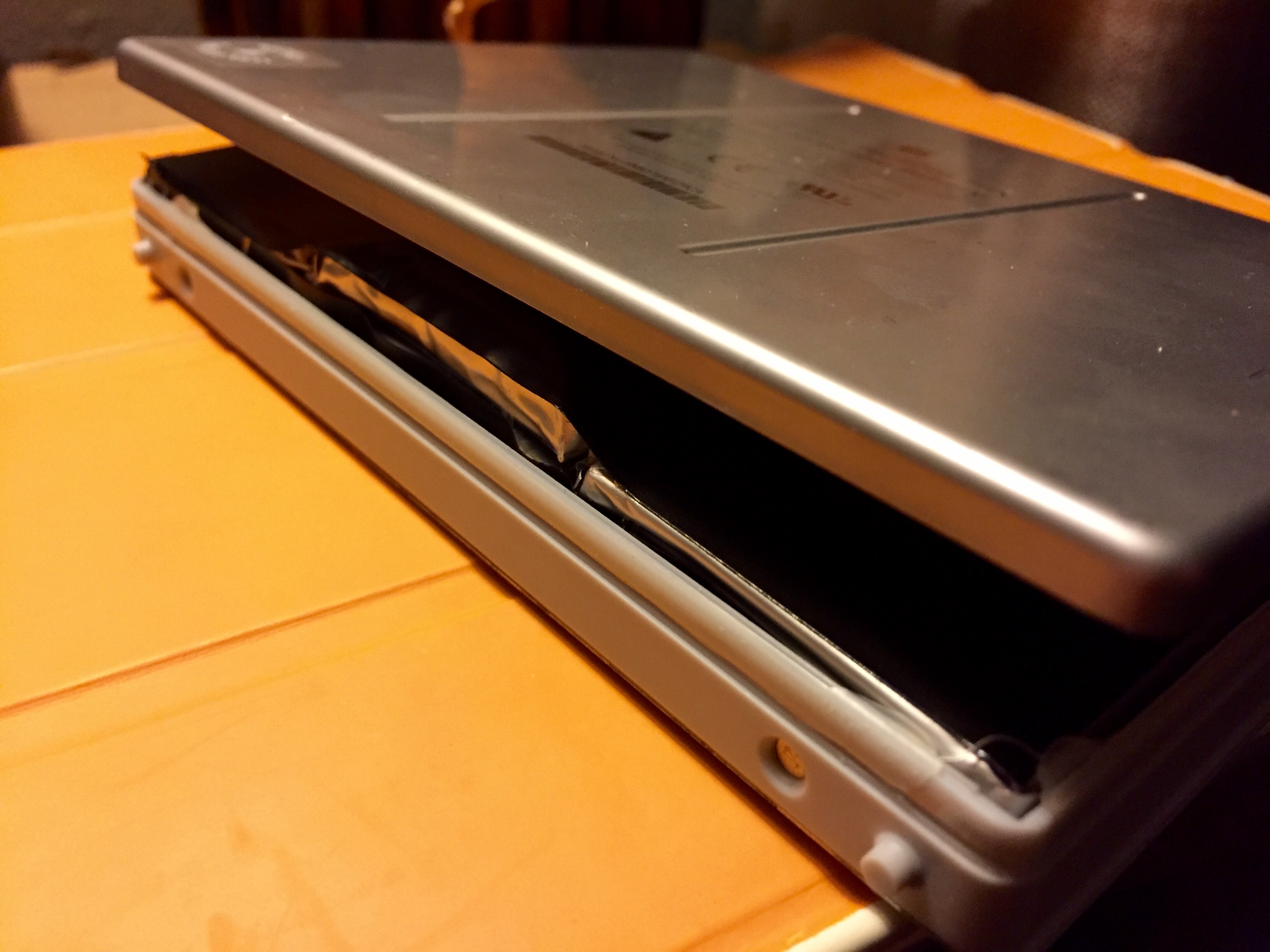

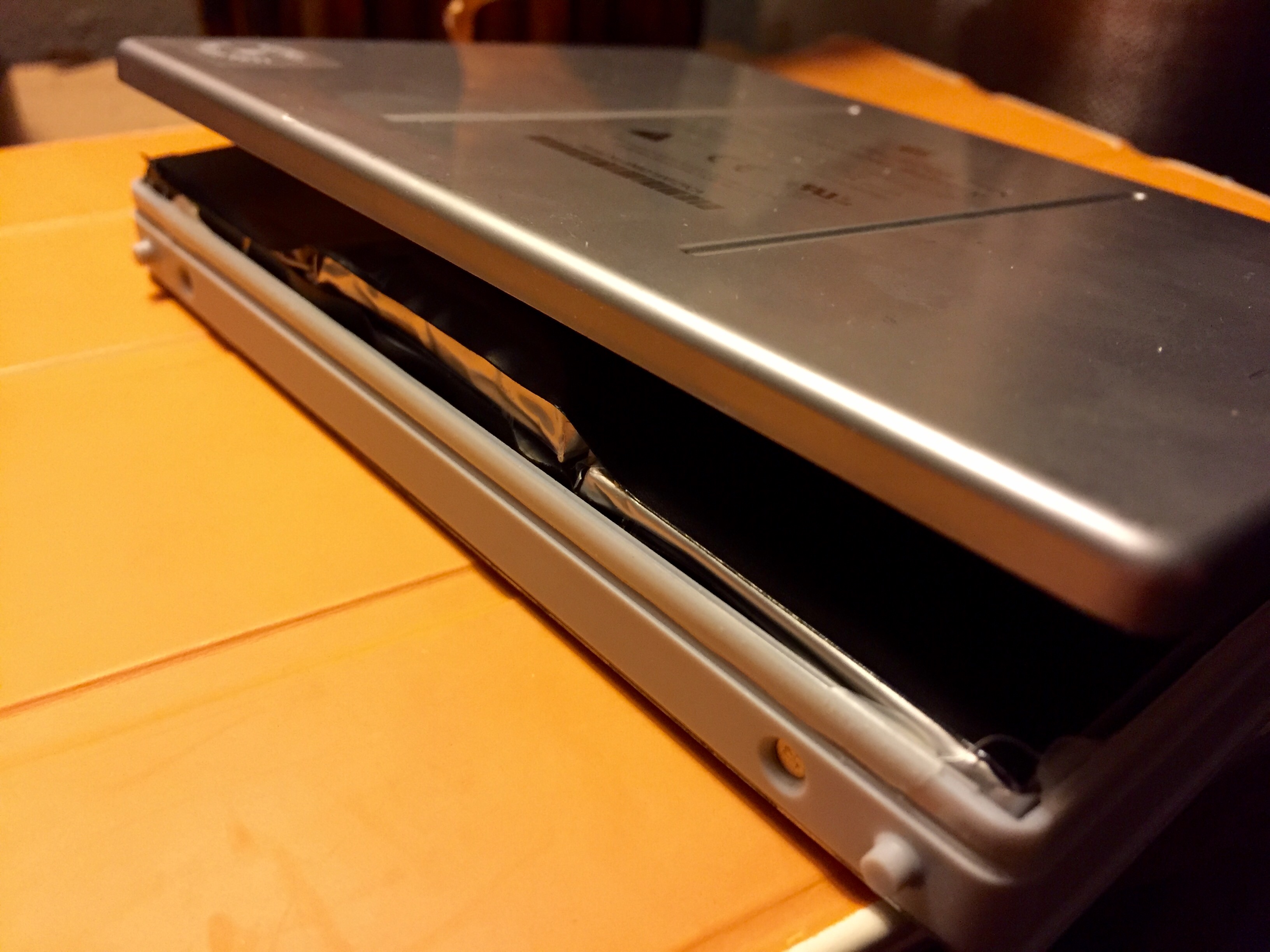

Truth be told, the laptop is my wife's and she uses it a few times a month when she doesn't want to sit in our study for hours at a time working on her online courses. I've been lobbying for her to get a MacBook Air or iPad pro, but she's attached to the old 15" beast from 2007.
We did take the battery out immediately; thank for the suggestion.

"Thankfully" this laptop is circa 2007, so the battery is removeable.
Here's what it looks like now:
