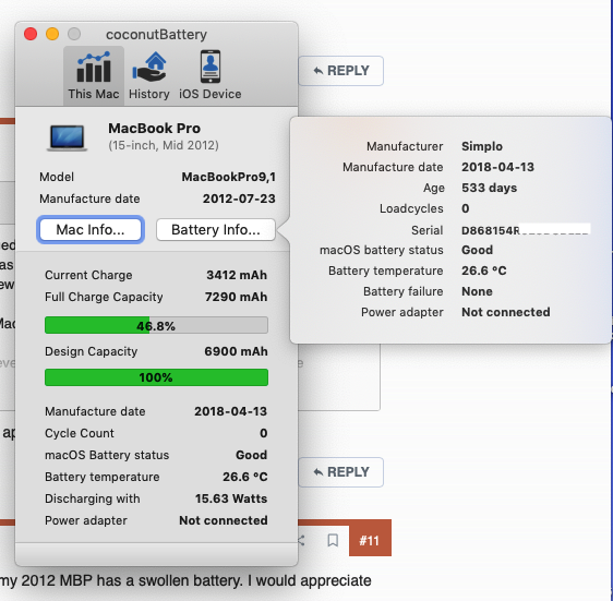

Update.
Got battery replaced in Apple Store. The bottom case resumed flat and the trackpad went back to normal click. The new battery looked fine (full capacity and Zero cycle count) except it is a bit old.

Update.
Got battery replaced in Apple Store. The bottom case resumed flat and the trackpad went back to normal click. The new battery looked fine (full capacity and Zero cycle count) except it is a bit old.View attachment 864717
