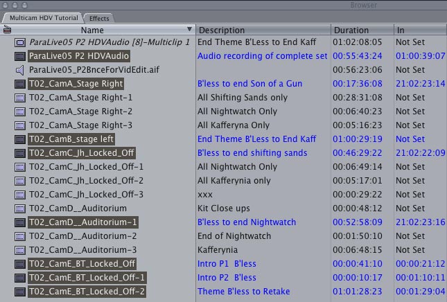

The following image is an example for a multi-cam edit bin, which shows the duration column (here there are no clips with the same duration, just to show you which column I mean).
