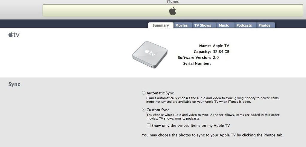

I'm not sure what use checking or not checking songs has in everyday use. The only use we have is that we set my wife's Nano to sync only checked songs and to sync all audiobooks. When she gets a new book she checks it and when she finishes a book she unchecks it and that controls which books are synced to her Nano.
I can see that some people were having problems getting the summary tab that I had b/c they had their :apple:tv set to stream and not set to sync at all. The way I used to have it was that I synced some stuff but also streamed so really the same computer was connected both ways and in the software's 1.x mode, you had to go to sources to choose which one. 2.0 makes this unnecessary since all non-synced media except for photos can be streamed through the synced machine. Just don't set it up to stream as if it was an additional computer.
Posting your screen shot made me realize that something was amiss. Everything is working well for me now. I always power down my ATV with my HT equipment and always had to reselect my PC each time. Now I don't have to do that which is cool. Thanks for posting the screen shot.

All you're missing is that, due to the way Take 2 reorganized the menus, you no longer have to specify a streaming library.
The feature set is identical, but with Take 2, they have removed the need to specify BOTH a syncing library AND a streaming library -- if you specify a Sync library, it adds all of the streamable content to the AppleTV menus, too. Automagically.

Thank you very much for the info. I'll reset the :apple:TV and try that. I had originally had the main Mac in the house set to sync, but nothing was showing up. However, I see from other posts that it is because all the video media was unchecked. This sounds like a great setup if it works as described.
HobeSoundDarryl
macrumors G5
WOW! That did work. Now 2.0 makes a lot more sense, and entries beginning with "My" (My Movies, etc.) also make more sense. Apple should much more clearly document this as it resolves the recurring gripe of having to sync for each type of media, etc.
Thanks very much to those who figured it out, shared it, and helped others (myself included) get this working.
