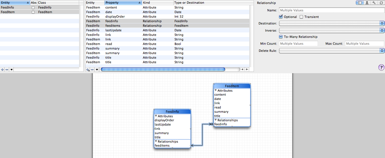

Titles is something I just picked, there is no reason why I can't change this during refactoring. However as requested by entities can be seen in the attached.
IF my NSManagedObjectContext is feed which is a FeedItem object will I have problems if two feeds contain the same or will the NSEntityDescription of FeedItem prevent that? Or by saying using the url as a key for that reason?
