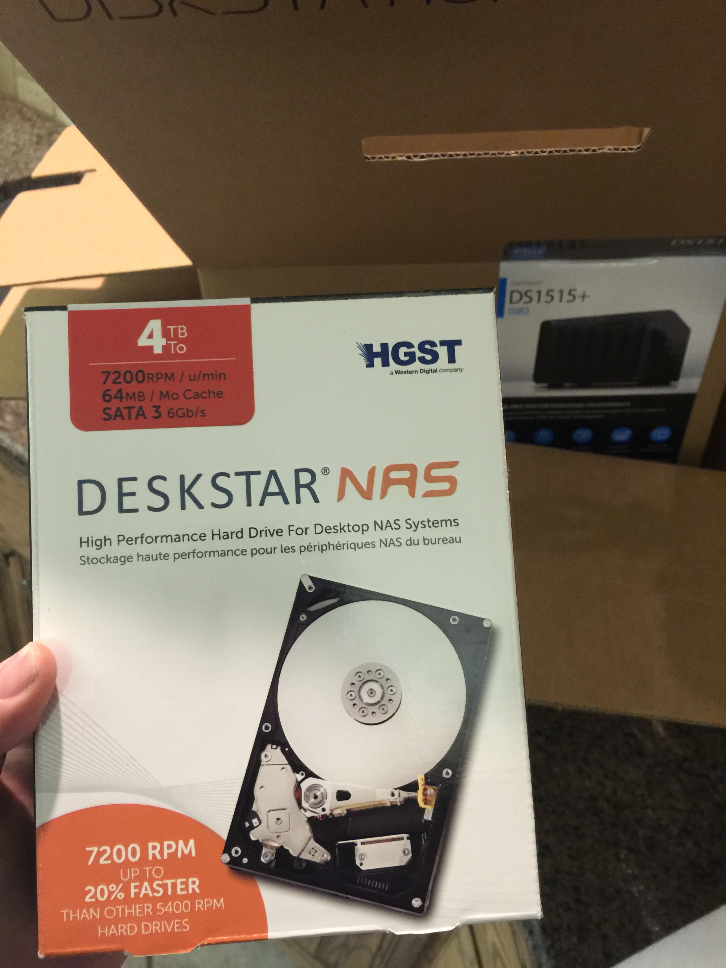

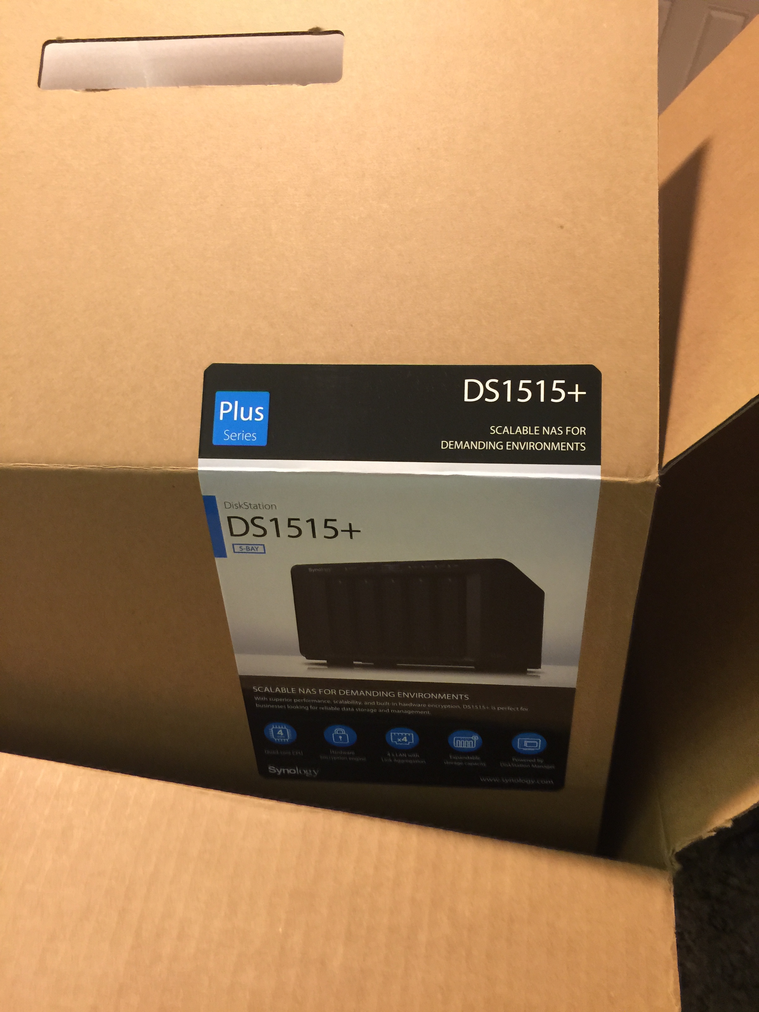

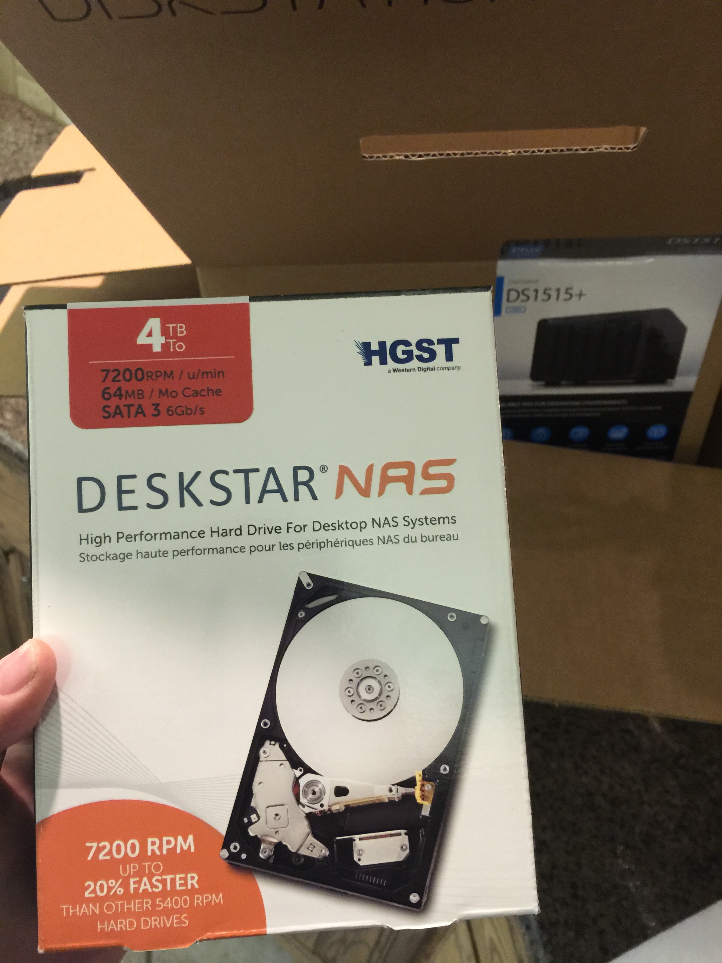

I actually just got my DS1515+ delivered today.
I just recently did the set up and am in the middle of creating folders and copying files over.
I also planned on doing some testing while I am at it.
I picked up 2 recommended replacement fans and a 4GB stick of RAM to max it out but first I am copying approx 3TB of info on a complete stock system with it's 2GB RAM and using 2 of the 4 ethernet ports and check temperatures, fan sound levels and if added RAM makes a difference.
I am using HGST Deskstar NAS 4TB HDD x 5 and using SHR, which is essentially RAID5. Except with SHR (Synology Hybrid RAID) you can mix HDD sizes. So if one of my 4TB drives died I could replace it with a 5TB if I wanted.
Yes the system is capable of being accessed remotely but I haven't touched that part of the system yet.
This is my 1st Synology NAS and just in the few short hours I've had it, it has completely changed my thoughts on a NAS. I've used less expensive devices before like the WD and Netgear offerings and this is definitely a "you get what you pay for" market.
I weighed the other options and for me this is the best scenario. I am currently using a MacMini i7 server with external storage, Thunderbolt and USB3. Both options have their + and - but for me, at least right now this NAS makes way more sense....again for me.
I'll let you know about how streaming is from the NAS to 4 AppleTV's compared to the MacMini.
This NAS isn't super powerful but a 2.4GHz QuadCore isn't terribly bad but it isn't a Quad i7 either. More to come.😎
The 1515 can also host websites, be a DNS server, etc, etc. It's a real nice system.

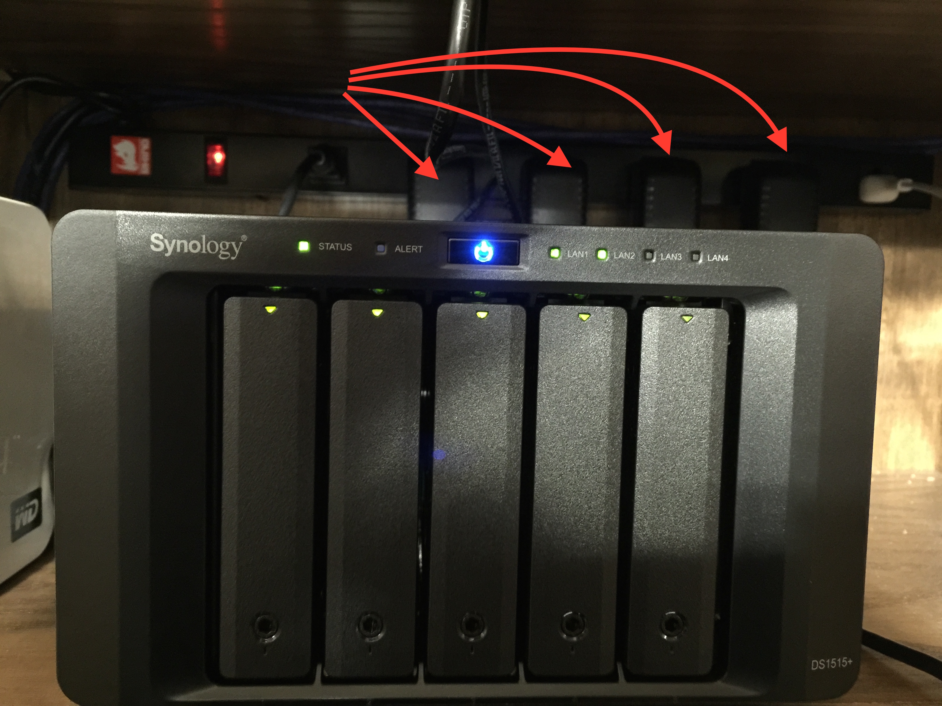

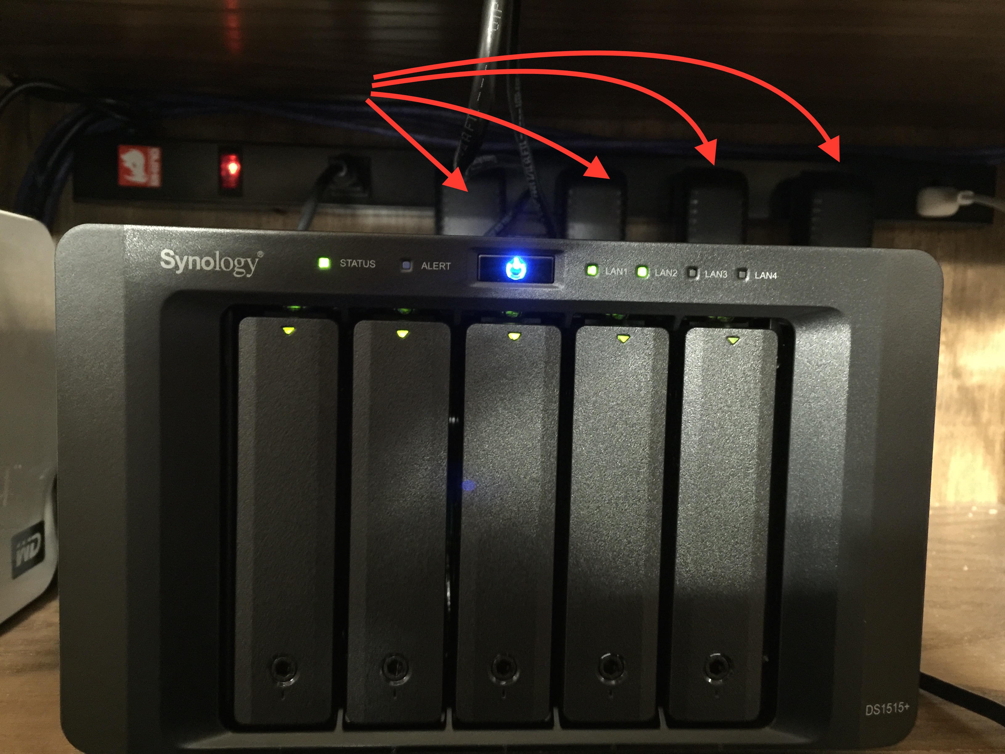

Still copying files over so I haven't tried any video streaming as of yet. So it may be tomorrow before I have any "real world" info.
One of the issues I had with the MacMini + externals was all the power bricks as you can see in the photo below.
I could have purchased more raid enclosures to consolidate my individual externals but I felt this was in the end be my better option.
I go from 2x 2foot power strips using 10 power connections down to 3 power connections.
I don't believe you would have this issue as you wouldn't be using as many externals.
I started with a 1TB, then added a 2TB, then a couple 3's then a couple 4's and before I knew it I'm sitting here with single external drives lined up.
I also did not want to build a dedicated RAID tower/computer. I wanted one of the smallest footprint I could get even if it may cost a little more.
**********Edit - forgot to add the photo -
The amount of space the power bricks were taking up was starting to get out of control. Behind the DS1515+ you can see the power strip I was working with, I needed 2 of those. So that was 4' of space not counting the MacMini and the external drives.

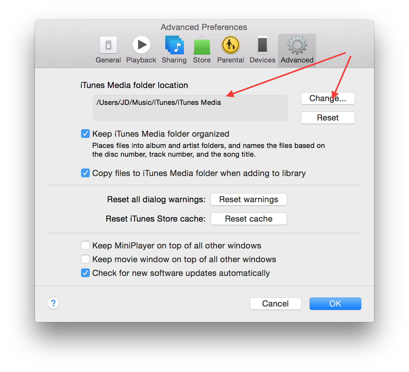

Yes and No.
Yes it can store and share all of your media files.
The No comes in that if you're viewing media from the AppleTV you need HomeSharing enabled, which only works on a computer.
So you must have at least 1 Mac turned on with iTunes running that is linked to your media on the NAS.
If you are viewing from other computers then you can watch movies straight from the NAS.
If you want the NAS to be your main iTunes storage you will need to tell iTunes by changing the location of the default media folder.
Go To iTunes ->Preferences ->Advanced
and click the Change button to point iTunes to where you are storing your media files.
You can do this if you're using a NAS type device or if you just want to store your media on an external USB or Thunderbolt drive.
So even if you use a MacMini and an external drive, you'd probably want iTunes set to open on power up of the machine and HomeSharing enabled.
This way if you restart your remote headless Mac Mini, iTunes will automatically open and you'll immediately have access to your media from your AppleTV without having to remember to manually open iTunes.

Ok. Thanks for the info. Would Iphoto work the same way? Point iPhoto to your photo location. So the only thing is that time machine won't work, correct? I'm so confused why some users don't like NAS solutions, and some do.
Time Machine seems to be working just fine for me. I have 6 Macs backing up 100's of GB's since late last night with no hiccups.
As for changing iPhoto's default save location, it is as easy as dragging and dropping the current iPhoto library to a new location and then double-clicking the file to open iPhoto, it will remember the new location.
http://support.apple.com/en-us/HT1229

I do have to say the more time I spend using this NAS the more and more I like it. I don't think you can understand how much different a DS1515, 1815 or 2015 is from the typical consumer NAS device. It's actually quite impressive.
QuadCore CPU, DDR3 RAM, 4xGigabit Link Aggregation, 4x USB 3.0 ports, 2 eSata, expandable to 90+TB's of storage. WebServer, DNS, GitServer, Wordpress, Bittorrent Server and the list goes on and on. This little NAS box is pretty cool.

I actually haven't noted the Time Machine backup speeds. All my Macs have been doing their hourly backups and I just kind of forgot about it because they have just been performing as they should.
This isn't much of a TimeMachine test yet but each of the machines move very fluidly while navigating through the TimeMachines backups. I haven't had a need to try recovering from a backup but I may just do a format and reinstall from backup just to test it's speed, then repeat but do it from my Mac Mini ->Thunderbolt enclosure and note speed differences if any.
As for the setup, I just went to the Synology website. Downloaded the Assistant app from https://www.synology.com/en-us/support/download/DS1515+.
Then went through the setup and I went with SHR which is Synology's Hybrid Raid. It is very similar yet with some differences from normal RAID.
SHR allows you to mix different HDD sizes. You can use the raid calculator here https://www.synology.com/en-us/support/RAID_calculator to see the difference between SHR or SHR2 with normal RAID 5, 6, 10, etc.
SHR is more similar to a RAID5 setup and will give you 1HDD worth of failout protection. So if you are using 5 - 4TB drives, your usable space is 16TB with 4TB of protection.
SHR2 will give 2 HDD of protection. So 8TB of protection and 12TB of usable storage.
