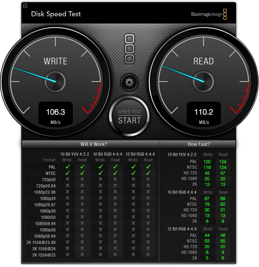

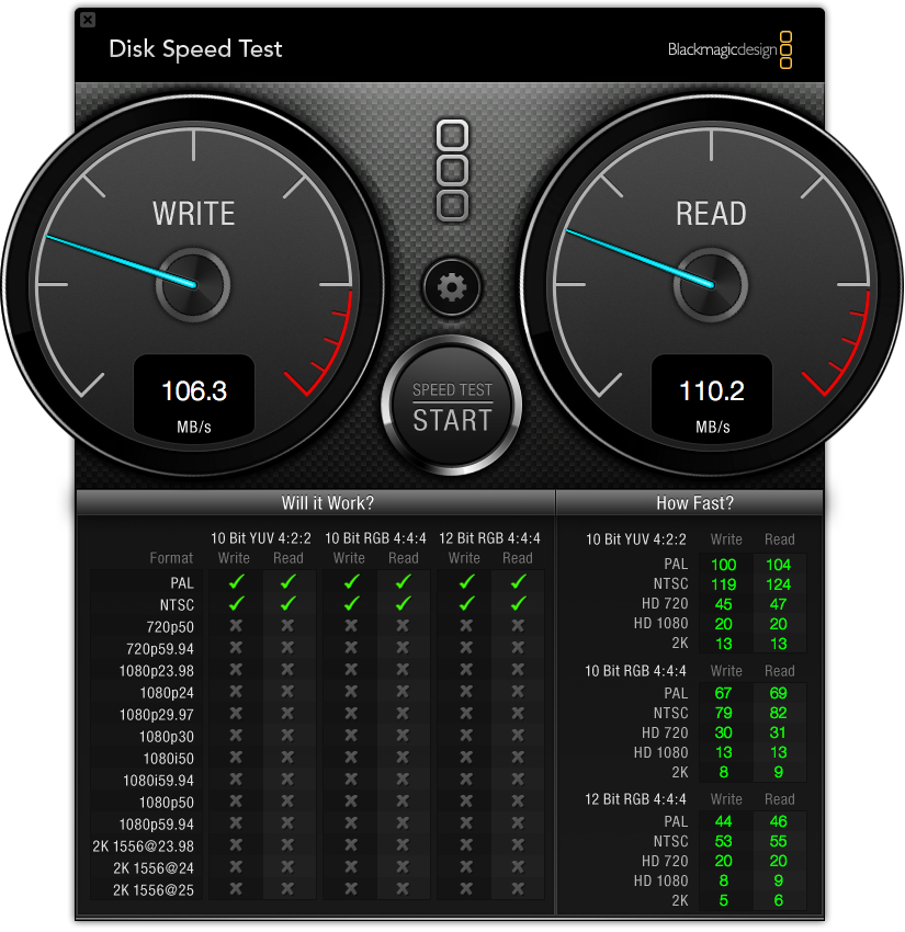

I've got a DS1511+ and was wondering what type of read/write speeds you are getting for your media?
DiskTest with my DS1512+ Hybrid RAID SHR (single LAN hookup):
5 ea. 3TB WD RED drives (about 1/2 full)
Thanks for posting. I'm seeing similar. I feel better about my setup now!
That's good to know for me as well ... I haven't seen many postings regarding data transfer speeds to a NAS, so I don't know if my readings are bad or good. 🙂
I do know I probably should reduce the number of LAN switches between my Mac Pro and the Synology NAS box in the basement for a more direct connection (or possibly even ethernet aggregation with 2 lines and a better switch/router). 😀

My old setup maxed out at 10 mbps on the synology NAS using cat5 that was prewired in the house when we moved in. The NAS was in the closet and the iMac in the study. The cat5 also carried phone signals. I decided to move the NAS to a separate lan recently and added a new gigabit switch off that mainline and a new gigabit router complete with cat6 cables from the switch to the router to the NAS and iMac. I also moved the NAS to the study. Speeds went from 10 mbps to the average of 100 to 105 mbps that I'm seeing now. A huge increase in performance for me to get to this point.
I also thought about adding a switch that offers link aggregation. I looked at the Netgear Prosafe GS108Tv2 that offers aggregation. Some folks use it on the MR forums. It runs about $80 at Amazon, but I decided that the hassle of configuring it might not be worth the additional r/w speed bump.
