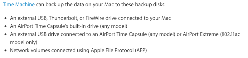

I don't think you will get a clear answer on this. Apple previously said networked Time Machine backups only worked properly with a target Mac running OS X Server edition or a Apple Time Capsule, or the new 802.1ac Airport Extreme with a USB drive attached. More recently that support document changed and it now says it will work on a network volume connected using AFP (which is what your Synology is doing). So for some reason Apple loosened up a little here.
So with that said, what often happens is Apple will release a new OS version that has some changes to either AFP or the way Time Machine itself works, then that breaks things with some of these third party NAS solutions. You see posts here about it with every major OS release. Then you have to wait for the NAS vendor to release an update to make the NAS compatible with the new OS X version.
I think if you stick with major band name NAS vendors like Synology or QNAP you will be okay until there is an OS X update. Then I would be very careful about updating the OS until you make sure that update won't break your Time Machine setup. So bottom line, I think it is a bit more risky than using say a Time Capsule, but the risk can be managed. Sounds like you are cloning in addition to the NAS, so all your eggs are not in one basket anyway, which is a good thing.
https://support.apple.com/en-us/HT202784
