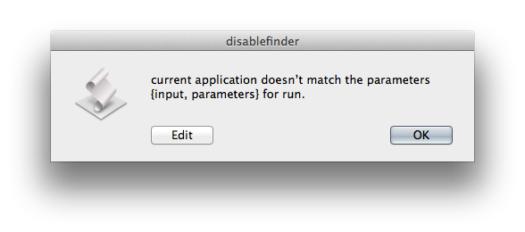

Thanks for your help but I get this error message with your code? 🙁
You can save this in Automator as an application with a Run Applescript action.
In Applescript Editor as an application by removing the {input, parameters} part in the on run handler.
