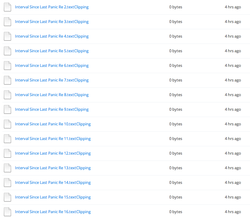

I only see empty files, as in 0 bytes.
Nothing in any file.
Just paste your last report here, only one will do.
damn you're right, here it is:

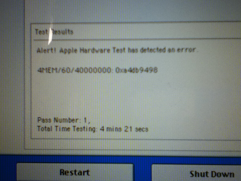

i just made the hardware test, and it found an error!
4MEM/60/40000000: 0xa4db9498
what does that mean?
will apple fix that for me if i show them the error?
i still have the warranty with the apple care and all that.

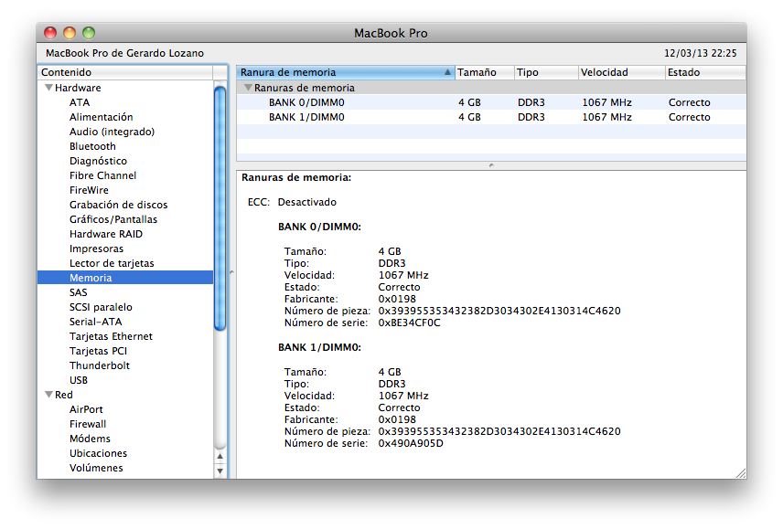

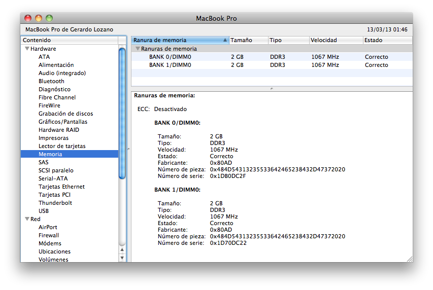

I am not an Expert but I am positive your Memory (RAM) is faulty, did you change (Upgrade) Memory lately?
If you changed it I recommend putting the old RAM back and see if you still get them crashes, if not you know.
Also, the 0xa4db9498 means there's a memory error at 2765853848
Edit: In post #4 I said it is GPU related, now, if your MBP was using the Intel HD GPU at the moment of the crash it was using RAM, so that might be the reason the report shows the GPU as the cause but most likely it was the RAM.

holy cow :O, yes, i did a RAM upgrade, imma put the original RAM back and check for crashes.
Here's a screencap of the RAM i'm using right now:
What's the brand, I would avoid Corsair, lots of complaints.
The "new" RAMs are Kingston.
Damn, it still crashes even with the old RAM that came on the mac, and when using these, the hardware test doesn't find any errors.
I think imma try luck at applestore again, tell them that my mac crashes all the time, show them the error that Apple Hardware Test found. (for this, i think i might put back the upgraded RAM so i can show more complaints 😉 , cuz again, with the old RAMs the hardware test doesn't find any errors).

also a screencap of the old RAM.

Leave in the old RAM, although it should not matter to Apple since you can upgrade yourself they will complain about the error and that it is 3rd party.
Seems the same as before, GPU problems, you could try one thing more but it's a bit of a job, if you have a USB stick minimum 8 GB or an external disk you could try installing OS X on it, then boot from it and see how it goes.
But, before you do, there is another thing you could do and it takes only a few minutes, make a new User Account, has to be new, then login into that account and see if the problem persists there, if you still got trouble try the above solution (installing OS X on externe), only if you have done both it is almost sure a GPU problem.
It still could be a bug in OS X but I think it's not since it's an earlier OS.
Put the factory RAM back in. Apple will (correctly) fault the aftermarket RAM that is causing the hardware test error and send you on your way. I'd contact Kingston for warranty replacement of that, but it seems to be a different problem than the repeated panics your computer is having.
Try installing OS X on it, then boot from it and see how it goes.
Only if you have done both it is almost sure a GPU problem.
I used a guest account, and it crashed. I think it's a GPU problem too, because most of the times that it crashes is while i'm using Expose, Spaces, or zooming on Photoshop.
I also turned on my mac on Safe Mode once, and it never crashed.
I sent my MacBook at Apple again, with the factory RAM in it, they told me to send them an e-mail with the picture of the error that AppleHardwareTest found. I really hope they can fix it 🙁
Thank you so much guys for your support 😀!! i'm gonna give you any news of my macbook once they give me any 😉
