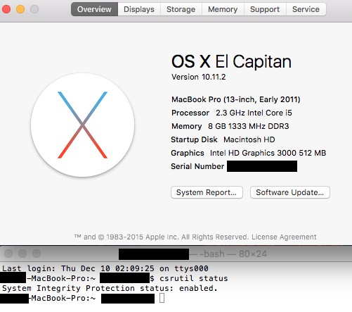

    Is it just me or is SIP bugged.
    1. disable SIP from recovery terminal csrutil disable
    2. check status and it says disabled
    3. boot to main system and check status and it says disabled
    3. update Xcode and open it up and let it install components
    4. check for SIP status on main system and it says enabled
    5. boot to recover and check status and it says disabled
    6. boot back to main system and it says enabled
    7. boot to recovery and run csrutil disable even though it is already disabled
    8. boot back to main system and check status and it says enabled
    9. install os x on top of the one u already have
    10. check status and it says disabled
    11. open Xcode and it reinstalls components then same problem SIP enabled even though it is disabled
    long story short
    csrutil status shows disabled in recovery and enabled on main system
    the heck is going on, is it a safety feature apple force enabling SIP on macs with Xcode installed or is it a bug which apple engineers aren't skilled enough to fix.
    using 13 inch early 2011 MBP 10.11.2 and same problem occurring since 10.11

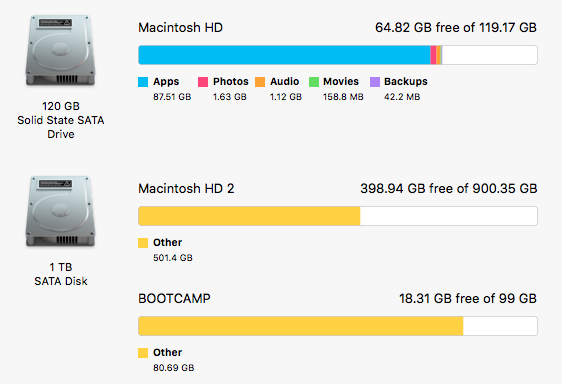

    this is a really odd and annoying bug, any idea on what might be going on
    could it be because i got 2 hard drives
    macintosh hd :10.11.2
    macintosh hd 2 :10.11.1
    bootcamp :windows :10
    even tried clean install and it didn't get fixed

    i booted to recovery did a csrutil clear and disabled firmware password and did a NVRAM reset, then booted back to recovery and successfully ran csrutil disable and turned firmware password back on, however booting back to my system still shows that SIP is enabled, even though recovery still shows disabled.

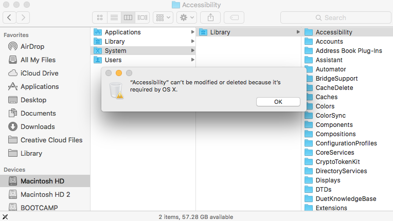

    Have you tested whether SIP is actually disabled? During the beta, the system didn't always report this correctly. You can try out by copying a file into the System folder (password required).

    i tried that, i can't copy or delete files in system folder, so it is reporting it correctly,

    @abcdefg12345: Even in Yosemite, Finder won't let you delete those files. That's why I asked: add something to the System folder.
    Try the command line instead:
    Code:
    cd /System && sudo touch test.txt; ls -A
    What does it say? When you run "csrutil status" from the same Terminal, what does it say?
    asks for password then it says
    Code:
    touch: test.txt: Operation not permitted
    .localized    Library
    running csrutil status in recovery terminal says:
    System Integrity Protection status: disabled.
    running csrutil status in main system terminal says:
    System Integrity Protection status: enabled.
    driving me nuts.
