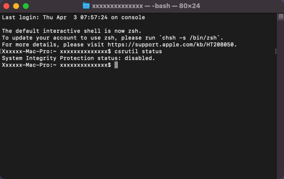

Hello!
Yesterday I noticed that for some reason S.I.P is disabled!
I try to turn it on in recovery mode with the csrutil enable command
after I restart the computer it is disabled again
OpenCore 1.0.1 is installed
Can it cause any problems at all if it is disabled?

According to documentation, macOS Ventura or newer require lowered SIP settings and Mac Pro require lower SIP settings depending on WiFi/BT/GPU installed.

A few weeks ago I tried to install the open Core legacy Patcher and after the installation the windows boot icon disappeared from the O.C boot menu
I didn't figure out how to make the windows launcher icon visible, so I deleted what the legacy Patcher installed in the EFI directory and copied back the Open Core 1.0.1 version and maybe I did something wrong because before installing the Patcher, S.I.P was always enabled
I would have liked to be able to boot from a USB 3 port, which is why I thought Legacy Patcher was a good idea.

I'm using Monterey and I don't plan on upgrading to a higher version because it doesn't make much sense
I have an rx6600xt video card and I don't want to get rid of it and use a weaker card because of the newer OS
don't mix OpenCore with OpenCore Legacy Patcher.
