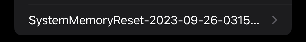

Has anyone else had SystemMemoryReset when charging overnight? I have to type in my passcode and all the apps were reloaded so I am sure it was rebooted at night.

Yes, happened to my 14+ twice last week. Called support and got them to run diagnostics and they advised the diagnostics did not indicate any hardware issues. I re-installed iOS 17 via the 'Update' recovery mode option and haven't had that issue yet.

I see. Did this happen in the previous iOS16?

In the case of my 13PM, yes it started in iOS 16, I don’t remember it ever happening in iOS 15. I mainly notice when it occurs because I see on the Lock Screen that I have 2 automations configured, which it alerts you to after a reboot too.

Did you do a full reset or something?

Sure did but only once. With iOS 17, it happened twice consecutively. Anyway as long as there are no kernel panic logs in Analytics, you can safely assume it's just a software issue. If it really bothers you, Try a hard reset first and if the problem doesn't go away, you could use the 'Update' recovery mode option - With your phone connected to a Mac or PC with iTunes, put your iPhone in recovery mode (Press Volume Up, Volume Down, Power button until you see the 'restore' icon. Finder/iTunes will ask if you want to restore or update your phone, make sure you select 'Update' as that'll simply re-install iOS while preserving all the data and settings.

Thanks. Have tried restoring it before, but the problem still exists.

Even with iOS 17.0.2? Maybe get on to Apple Support and have them run diagnostics to rule out hardware issues. With 8 Gigs of RAM you'd think the phone wouldn't struggle with RAM management.

Tests have been run and there are no hardware issues. This should be a software issue.
It's still happening on iOS 17.0.2 on my 14Pro and it's happening since iOS 16. I submitted feedback (Unexpected reboot while charging overnight).
Restoring did not fix the issue on my side.
