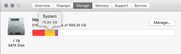

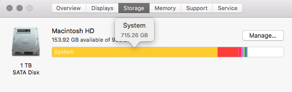

HELP! I have started to get warning messages about capacity and noticed that my 'available space' was super low. I have cleaned out the usual junk manually and run CleanMyMac as well, moved some music folders off the hard drive etc etc.

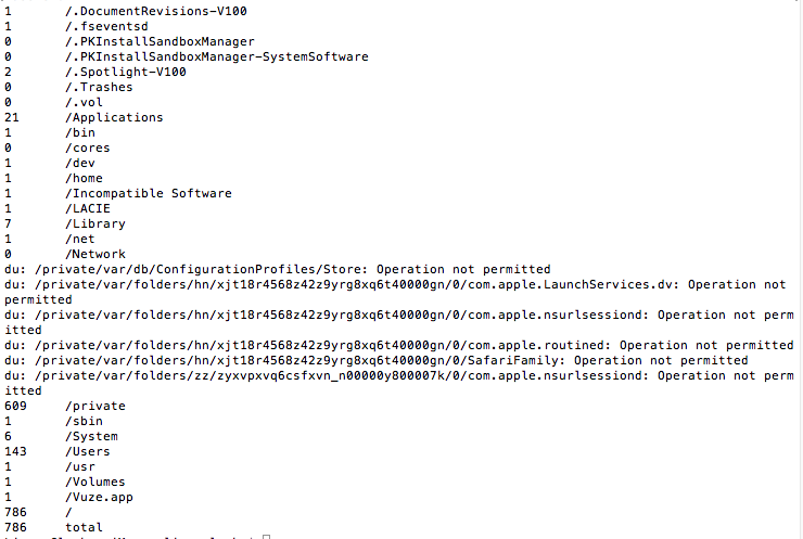

The yellow 'system' bar still moves between about 600GB and 850GB!! When I delve a bit deeper I see there is a '609' next to /private as per the screenshot. Oh how I wish I knew what that meant. I have seen in some other threads where there was a big number next to /Users and a couple of play by play options with what to do there but this has got me beat.

/private is way too big. Run the du command again and add private to the slash. By extending the path at the end, you can drill down. Since a lot of /private is protected, hopefully the issue will be in unprotected directories.

Cheers ... I realise /private is too big but poking around in there is over my head, I don't know where to start in terms of what is actually needed and what is unnecessary bloat.

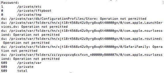

Just keep drilling down...
Code:
sudo du -d 1 -x -c -g /private/var
It seems /private/var/root/Library/Logs is where the issue is? But when I try to 'go to' that folder it says it can't be found? What's next Obi-Weaselboy? 🙂
