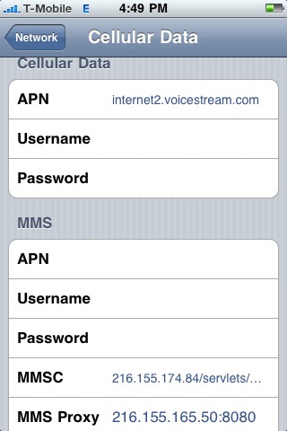

I'm using the T-Mobile Total Internet Plan, so my Cellular Data Network APN is set to internet2.voicestream.com, NOT wap.
What should my MMS settings be set to? The various ones I've found on Google haven't functioned so far. And sometimes the MMS APN field goes blank when I exit the menu even though I entered settings. :/
MMSC 216.155.174.84/servlets/mms
MMS Proxy 216.155.165.50:8080
Username and password leave blank

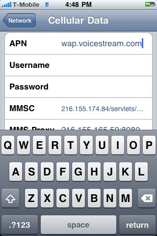

I entered wap.voicestream.com in the APN field for MMS (data has to remain internet2, wap only works if you use the blackberry plan).

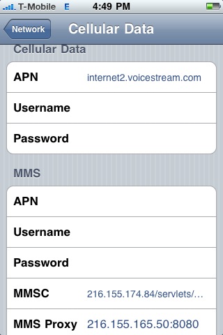

These settings didn't work for me. Also, when I leave the menu, the APN field is reset to blank.
Screenshots are attached, the first one is when I first enter the fields, and the second is after I hit Network to go back and reenter the settings page. See how the APN field is empty again?
Maybe I can't use these settings if I can't use wap.voicestream.com for internet?
And for the record; it's a 2G iPhone using ActivateMMS2G.

Interestingly, it seems if I put internet2.voicestream.com in the MMS APN field, the setting will stick, while wap will not. But, it still doesn't work.

I have tried it, and if you don't enter same APN in both options (DATA and MMS) it won't stick, MMS gets deleted as soon as you exit the menu. In fact, I don't use MMS right now, so I don't need it, but I always like to have everything set, you never know when you need to use it.

to those of you who its not working for I had to change my cell data APN to match my MMS APN (wap.voicestream.com)
I know some people may know this but some may not.....as soon as you enter your settings dont exit the menu .....reboot your phone 🙂 hth
That was it! That is why this thing never worked, I always exited the menu before restarting and it never worked. It just did! 😱
