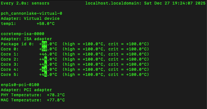

I found this program which looks like a great way to monitor the sensors and attempt to understand what's going on. Since coretemp was already installed, setting it up was trivial.
It interactively walks you through a scan of all available sensors, which ended like this on my 2018 Mini:
Code:
Now follows a summary of the probes I have just done.
   Just press ENTER to continue:
          Driver `coretemp':
          * Chip `Intel digital thermal sensor' (confidence: 9)
Following this, simply typing "sensors" produces this output
Code:
pch_cannonlake-virtual-0
Adapter: Virtual device
temp1:        +60.0°C
coretemp-isa-0000
Adapter: ISA adapter
Package id 0:  +48.0°C  (high = +100.0°C, crit = +100.0°C)
Core 0:        +46.0°C  (high = +100.0°C, crit = +100.0°C)
Core 1:        +46.0°C  (high = +100.0°C, crit = +100.0°C)
Core 2:        +43.0°C  (high = +100.0°C, crit = +100.0°C)
Core 3:        +44.0°C  (high = +100.0°C, crit = +100.0°C)
Core 4:        +44.0°C  (high = +100.0°C, crit = +100.0°C)
Core 5:        +44.0°C  (high = +100.0°C, crit = +100.0°C)
enp1s0-pci-0100
Adapter: PCI adapter
PHY Temperature:  +78.3°C
MAC Temperature:  +77.9°C
You can also run it continuously with with a command such as "watch -n2 -d sensors", which updates the values continuously and highlights the changes.

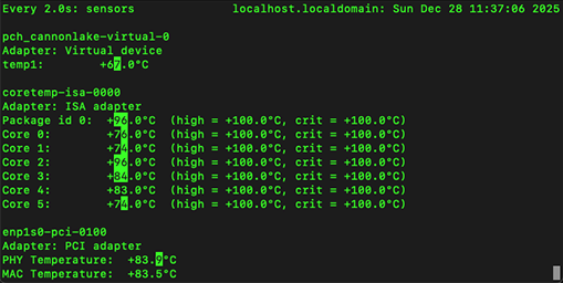

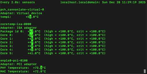

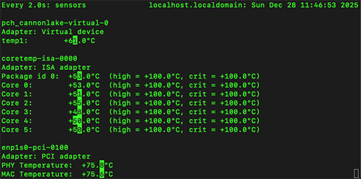

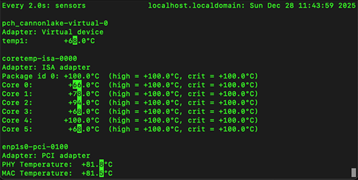

Tried a little stress testing on the 2018 Mini while watching temperatures and it was pretty interesting. Simultaneously tried multiple file transfers, zip files and heavy access of the web server. The mini didn't even break into a sweat. But I could hear the fan quietly running if I put my ear right next to the mini and could feel a gentle warm exhaust, so the fans were definitely running.
Then I opened the cockpit web console and went to the system metrics, which was a big load the last time I tried. That warmed things up.
Since I have no way to actually see fan speed, not sure, it seemed like the fans might have been running a little faster but they were still very quiet. When it finally hit 100c though, the fans started roaring at full speed.
FWIW, the CPU temperature shown in cockpit matches the "Package id 0" value in the sensors app.
The roaring fan seemed to do the job though. After just a few minutes the temperatures dropped way down and fan got pretty quiet. To be fair, the zip jobs also completed by then, but the other processes were still active.
Anyway, this gives me some confidence that the fan(s) are doing their job and my Mini won't get fried. I can see why someone might want to tweak this behavior though, to more gradually ramp fan speed up and down instead of the big transitions I heard. But, for a server, that doesn't matter much to me and the temperatures don't seem to be getting out of hand. For the most part, I won't be stressing it this hard either.
