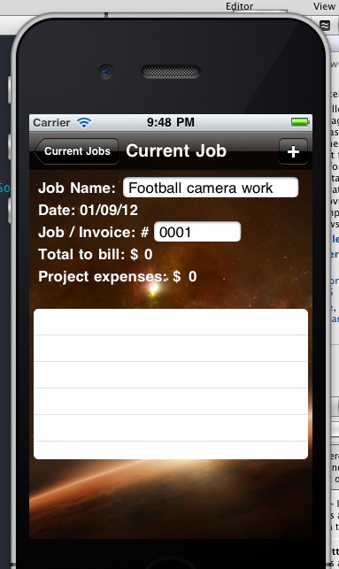

I have a UITableView in my UIViewController and implemented the delegates in my header file.
Code:
@interface JobViewController : UIViewController <UITextFieldDelegate, UITableViewDelegate, UITableViewDataSource>{
Since the UIViewController does not come with the methods I copied over the these delegate methods in my @implimentation
Code:
- (NSInteger)numberOfSectionsInTableView:(UITableView *)tableView
- (NSInteger)tableView:(UITableView *)tableView numberOfRowsInSection:(NSInteger)section
- (UITableViewCell *)tableView:(UITableView *)tableView cellForRowAtIndexPath:(NSIndexPath *)indexPath
I was ready to test the whole thing out and added my last line of code to refresh the tableview
Code:
[self.tableView reloadData];
and it gave me an error
Property 'tableView' not found on object of type 'JobViewController *'
Even though I added the delegates and created the delegate methods. Is it giving me this error because my custom view is of type UIViewController and not UITableView? I have see tableviews in other viewControllers so I must be missing part of this puzzle to make it work?
A UITableViewController comes with the property 'tableView' linked up already for free. As you are using a UIViewController you must create your own 'tableView' IBOutlet property and link that in IB as well. After that it should all work.
For this whole project I decided not to use IB and code everything from buttons to TablesViews. This is the code for my tableView which is pretty straight forward and set the delegates. How would I proceed with this IB link, or work around since the TableView is created progamtically?
It seems as simple as just making a method call to the cellForRowAtIndex [self tableView]; which I believe [self.tableView reloadData]; is kind of doing, but not working.

The problem is that your UIViewController does not have a UITableView property
called tableView.
Add a UITableView property called eeeeh 'something' to your UIViewController. Assign your incomeAndExpenseTableView to that property before you add it as a subview.
Then you will be able to call [self.something reloadData]
Call your table view tableView. Don't call it anything else. Create a property with that name. Create the table view however you like, code, IB, etc. Assign the value of the table view to your property. Then things will work.
Since UITableView uses a property with the name tableView and there is lots of sample code that uses that name I recommend that you also use that name for your table view property.
