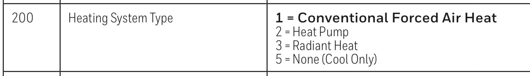

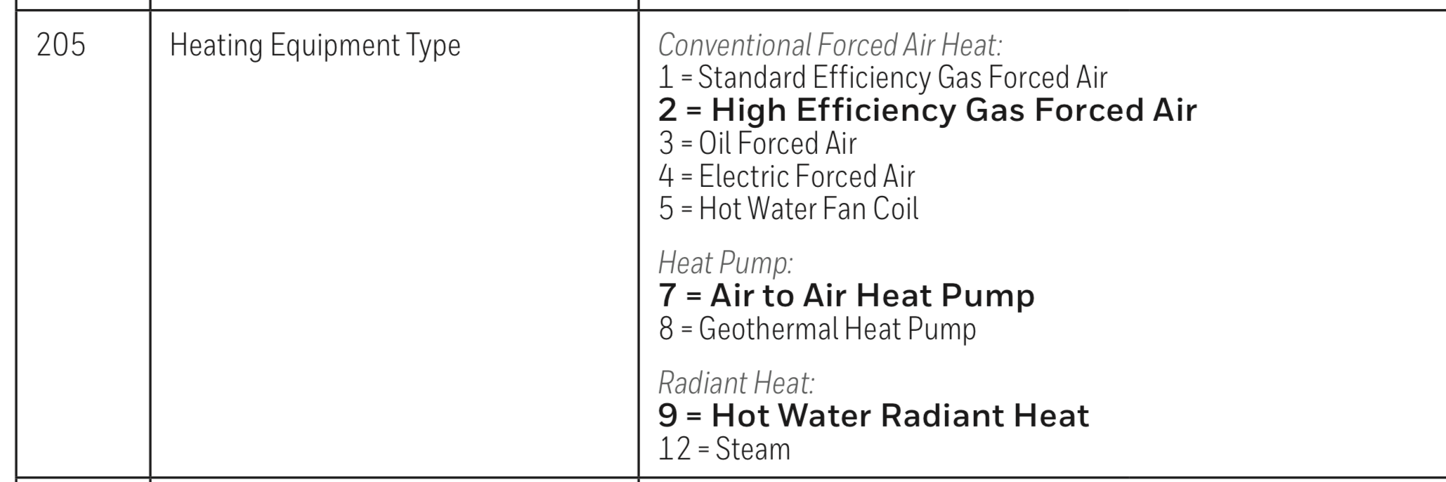

The thing I like about the Honeywell in your case is you and set the cycles per hour and aggressiveness to match the type of heat you have (radiant) and then fine tune it. The purpose of this is to get a balance between comfort and efficiency. Heating, cooling, refrigeration, etc is the most efficiency when its up to its design speed and temps so a longer run cycle is inherently more efficiency. However too long and you can feel the temp swings in the room as it warms up and cools off.

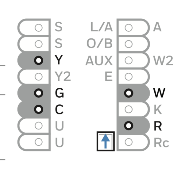

Plus it has a way to be wired in any crazy configuration you can imagine. Technically it would would be easy for you to combine this thermostat with your AC (if you have it) without a relay since you have a Rc and Rh terminals. And it can use batteries if you don't have a common (neutral) wire from the combi.
