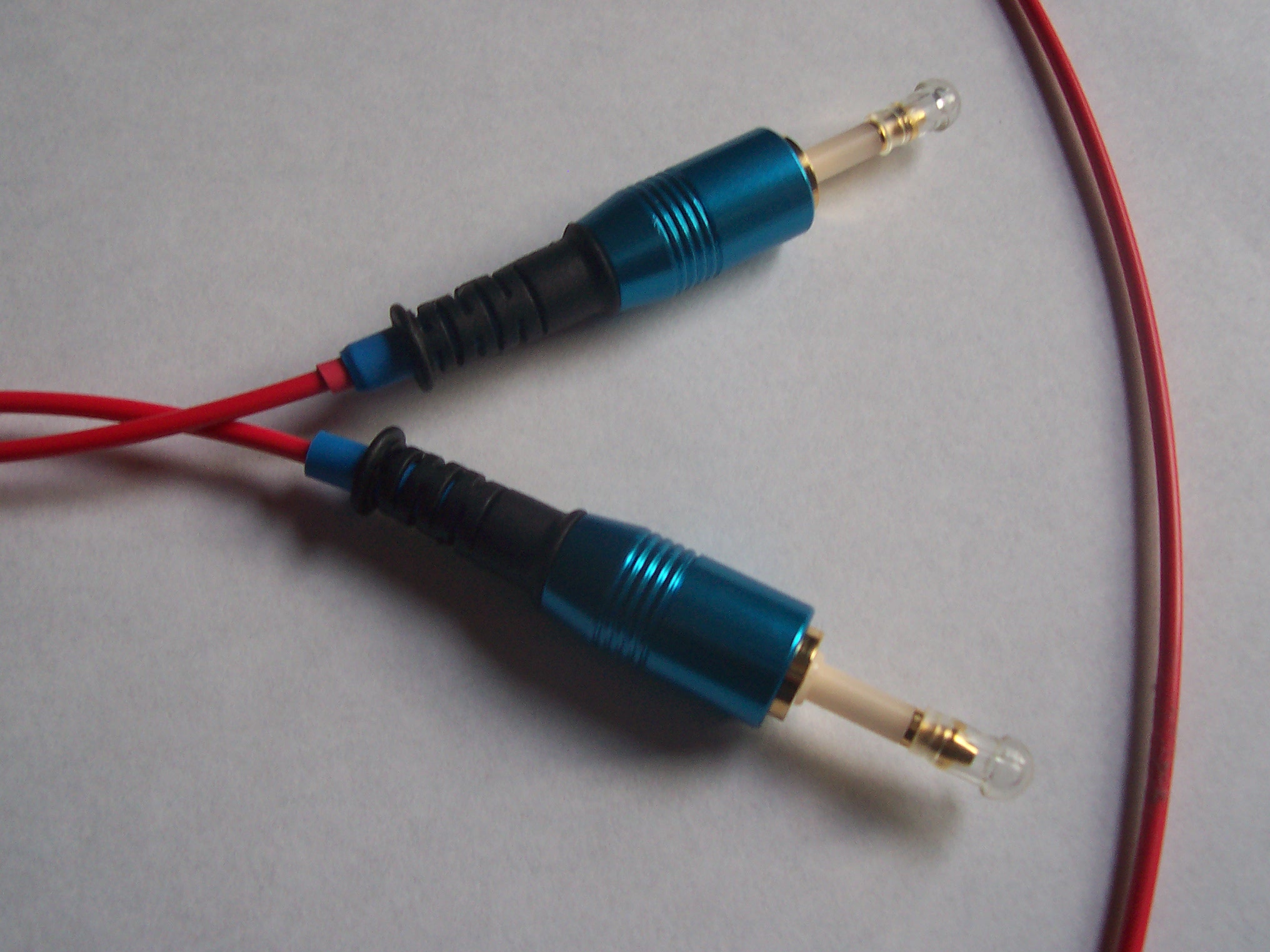

fiber cables have many different ends ... you need one that that is long and skinny like a 1/8" jack.
thanks for the pic! i can't find headphone jack-sized fiber optic cables anywhere, where'd you get that?
the skinny optical is called a "mini toslink" the regular end (that goes in most surround systems is just toslink)
Some come with the adaptor to convert the box end you usually see to the headphone size optical. I bought my many years ago and I though all were like that.
