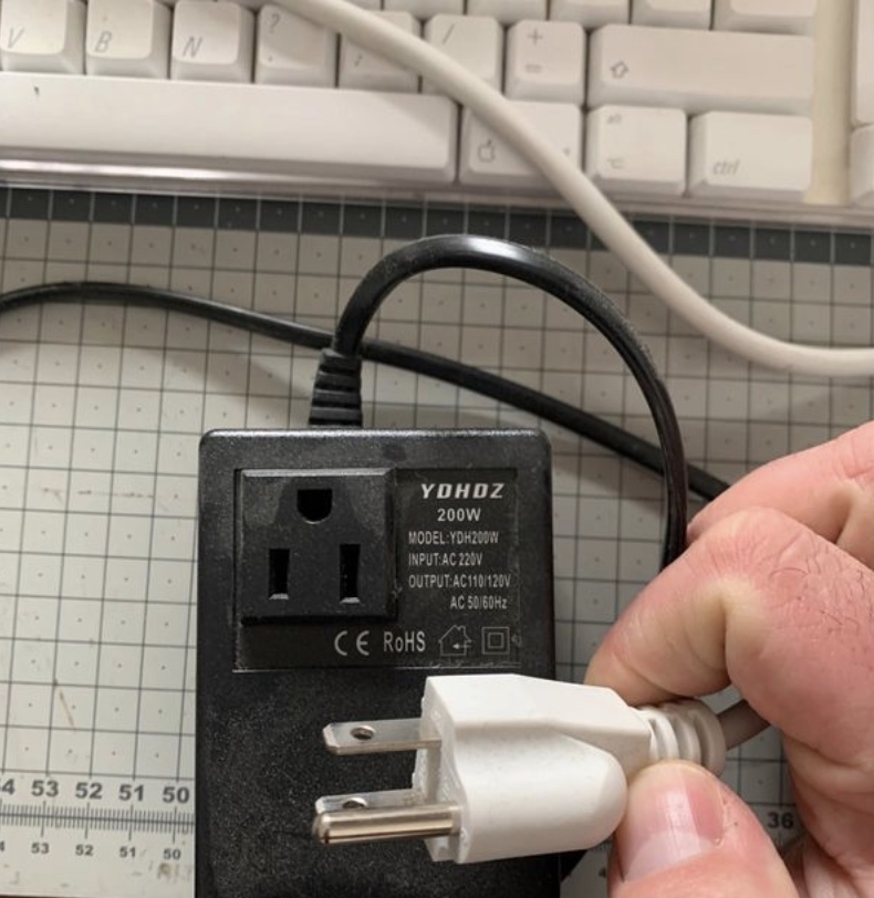

Hi, I'm reviving this fairly old thread with a similar query about iMac G4 power operating voltages. I was under the impression that they were dual 110/220V and could be used from the USA to Europe without any problem or additional converters.
I've just seen an ad for an iMac G4 with the following comment from the owner; "ATTENTION! it is American and therefore 110V compatible, I'll leave you the 220>110V converter" (see below):
Unless someone can confirm to the contrary, I believe all G4 iMac's are dual voltage and all the above shown 'converter' is doing is adapting the US type connector to a European type connector - not shown in the photo. Confirmation please.......
