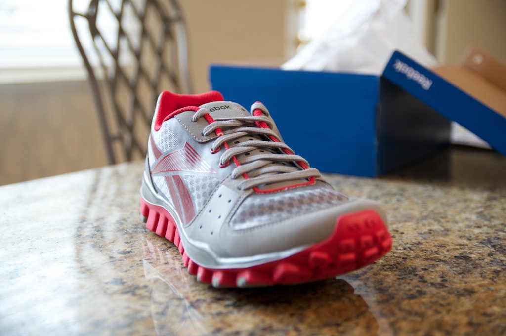

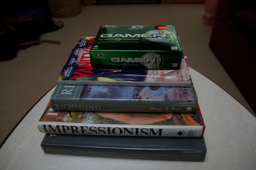

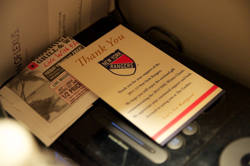

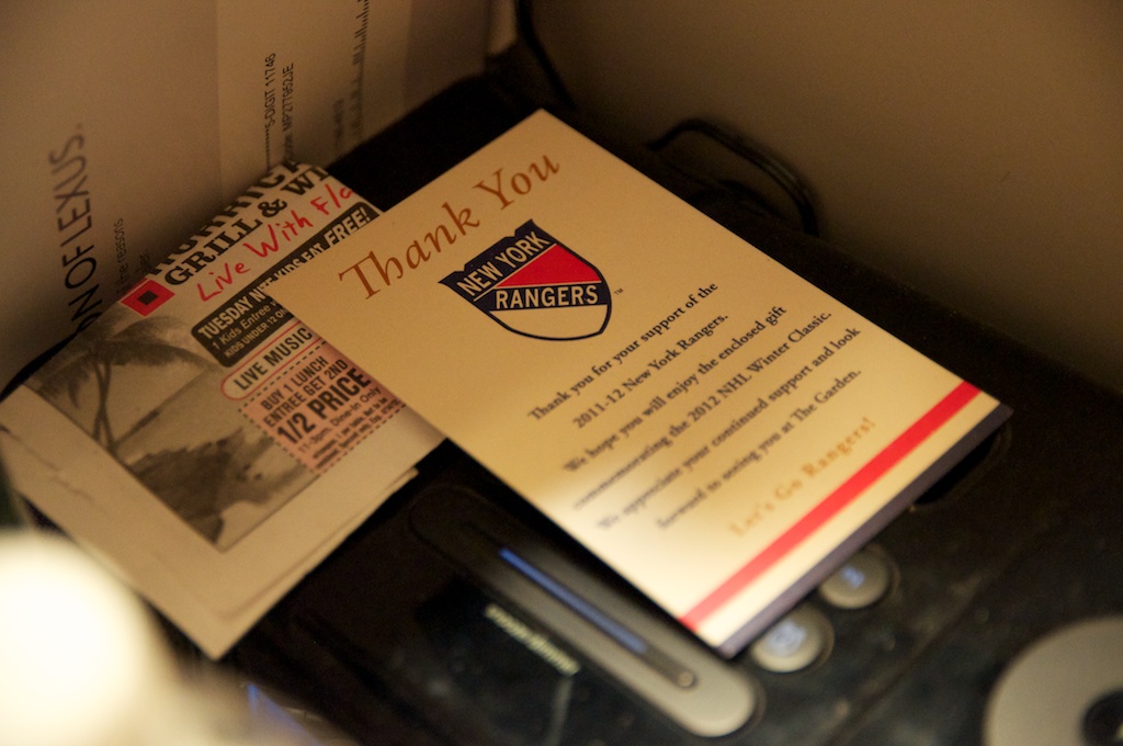

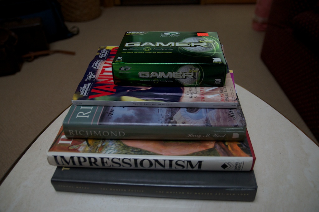

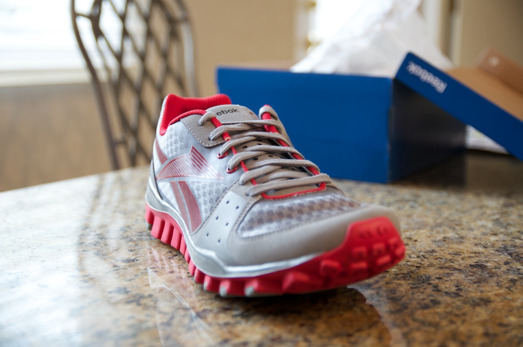

So I took some pictures today...here are 3 of them. (I scaled the images down, all photos were taken in RAW
in the Ranger flyer. I told picked my focus point on the Winter Classic text on the right hand side. But to me the big "Thank" seems more in focus to me.
On the sneaker picture the chris-cross of the laces the second hole from the bottom was my focus point but the further up you go seems to be more in focus.
On the books on the coffee table, the Vanity fair October 2011 on the spine of the magazine was my focus point, but the red Vanity fair seem to me more in focused.
Looking at this pictures, the focus of the lens is definitely off and you do want Tamron to repair it. This is not something you live with or adjust to. It makes it difficult to switch between lenses.
When you get the lens back, check it out thoroughly.
This is not a focus or softness problem
From the photos posted above, this does not look like back/front focus problem nor is it the softness problem. There are parts of image (around the center) which are perfectly sharp and in focus. What this means, is that the lens is fine, it just has a very small focal point/area at 17mm and f/2.8
To avoid this, either zoom in, or use smaller aperture.
If there is Back focus or front focus problem, the entire subject will be slightly out of focus. The lens will focus few inches in front or back of where it should actually focus, resulting in out of focus subject.
