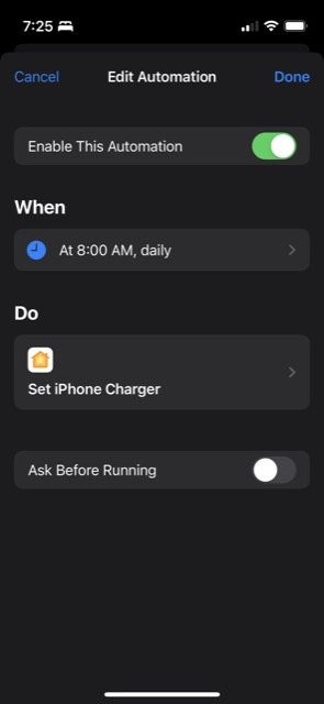

Here is an example.
Not all Shortcuts get that toggle as an option. Since this is a secure device (door lock) and AirPods aren’t, it will always ask for your confirmation on a secure device (iPhone or watch) before running. Very crusty indeed but it’s a security thing. It’s been like this with HomeKit devices since the beginning as well.
