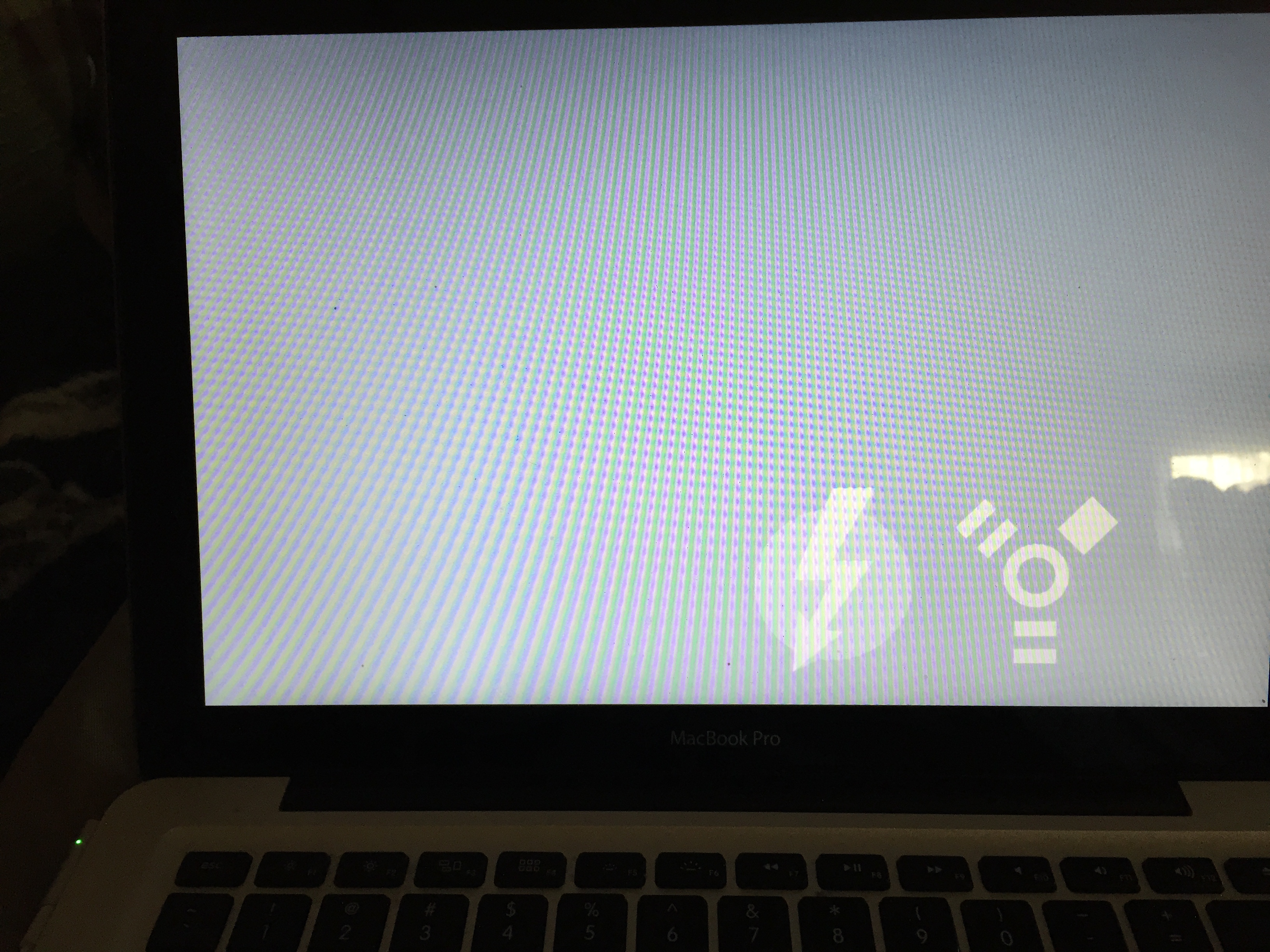

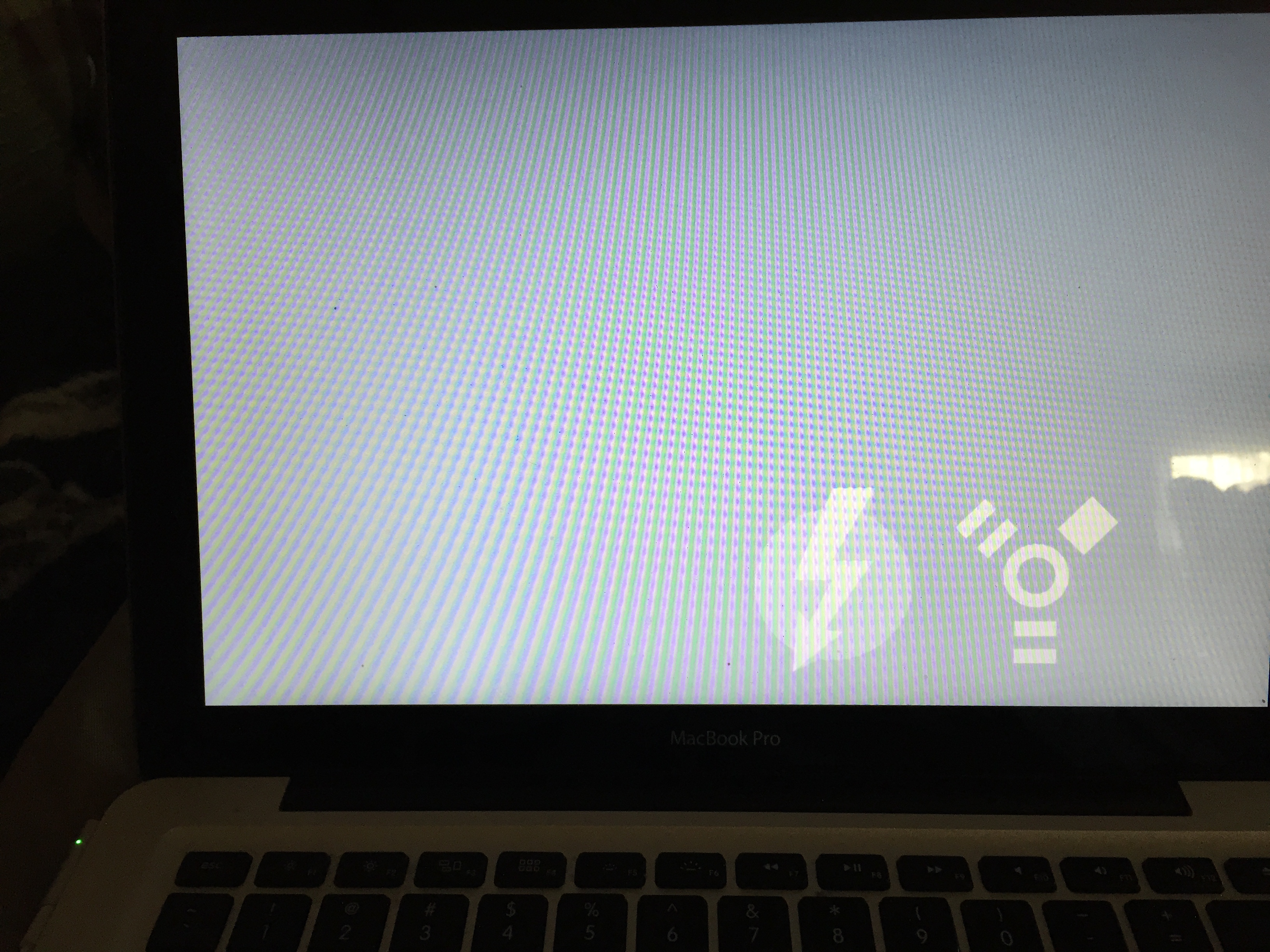

My only Thunderbolt equipped Mac also has Firewire, although come to think of it I've never booted it in TDM so I'm not sure what icon it shows on the screen.
The computer will show both icons until either Firewire or Thunderbolt is connected to another computer. On computers that have only Thunderbolt, a Firewire-Thunderbolt adapter in the computer set to TDM does indeed allow Target Disk Mode over Firewire.
Interesting, and of course I had to try it. I didn't go as far as connecting something else(I don't even have a Thunderbolt cable, and didn't feel like digging out a FW800 cable), but it was interesting to see both logos

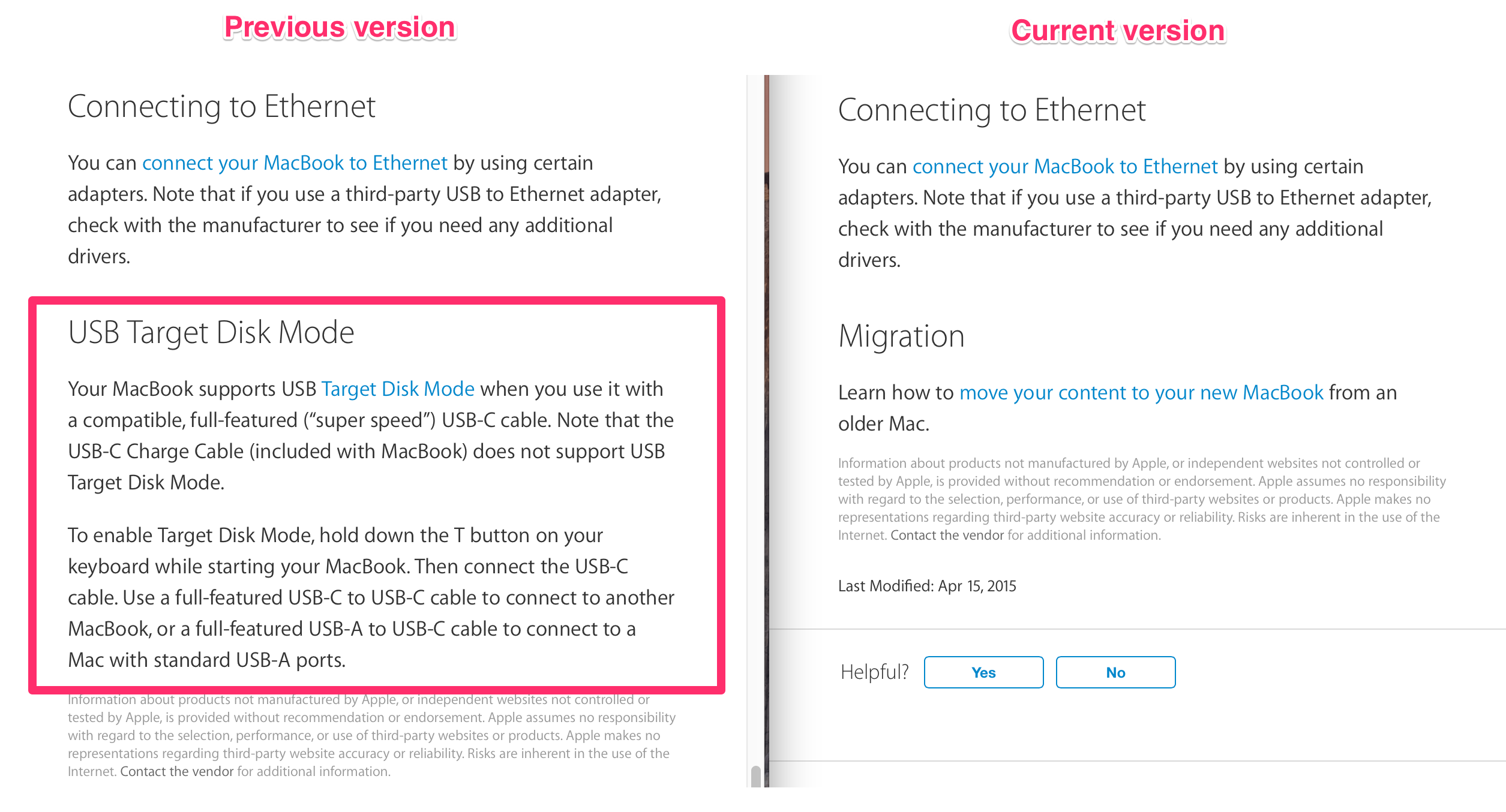

I wonder why Apple remove the text about USB Target Disk Mode from the page about using the USB-C port on the new MacBook? It said the the USB-C Charge Cable won't support USB Target Disk Mode since it is not full-featured.
