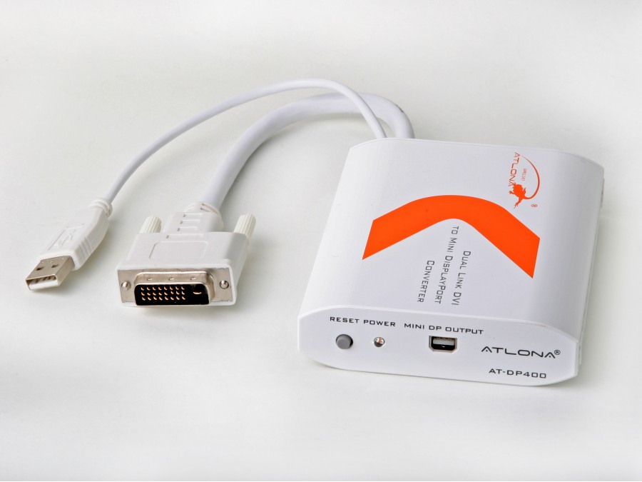

1) You need the following adapter to convert DVI to DP. A "normal" mDP-to-DVI adapter will not work. The iMac will not accept DVI.
2) If your PPC Mac doesn't have a dual-link DVI output, you can only get a 1280×720 resolution. The iMac will not display 1920×1080.

You should be able to find used DP400s for significantly less. I paid less than 10 bucks for mine including shipping. If you're fine with 1280×720 anyway, the DP200 is also an option. And you're correct that no G4 tower has DL-DVI out of the box.
Thanks, I will have a closer look, everything I am seeing is quite pricey but maybe I'll get lucky. Re your second point, is there a G4-compatible GPU that does have DL-DVI?
Unfortunately I still need mine, otherwise I'd be more than happy to let you have it. 🙂
The Dr. Bott Digital Video Link DL is a clone of the DP400. Gefen also have a DL-DVI-DP converter (although I have no experience with that one).

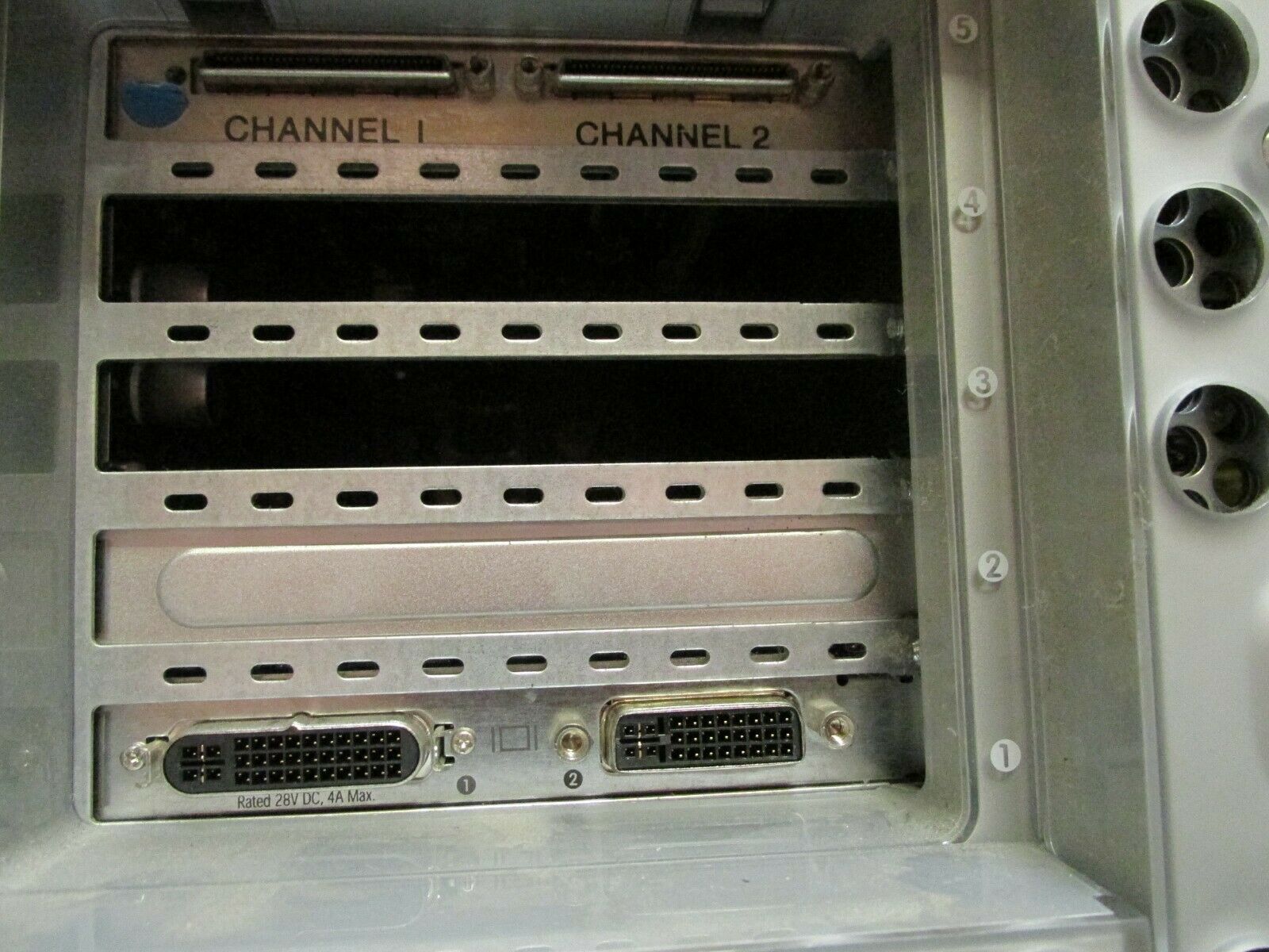

So... I have spotted an MDD that is peaking my interest... It has this card at the back, does anyone know what this might be? The one that says Channel 1 / Channel 2.

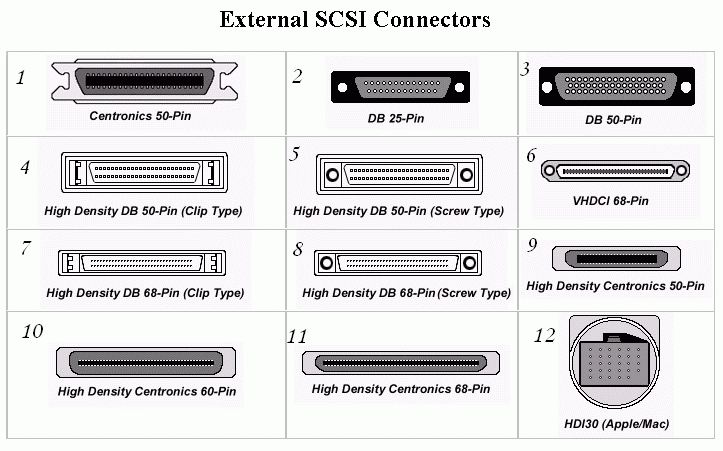

It vaguely reminds me of SCSI.

Thanks, this also looks like it might do the trick? I know it's not one of the brands you listed above, but it looks like it would work? At £14 I'm willing to take a punt!
Reactions: Amethyst1
That is what I like to see!!

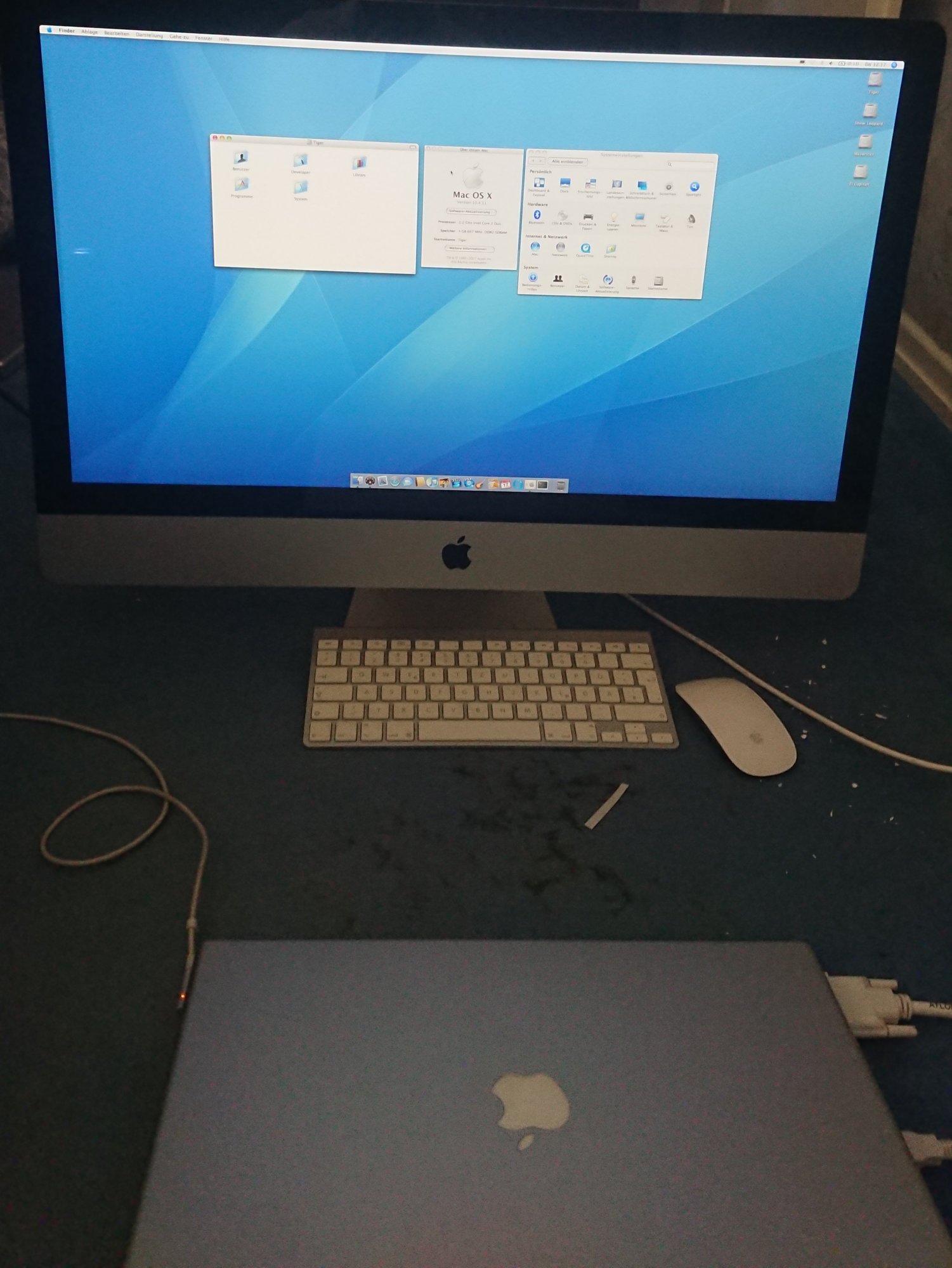

Yeah 🙂 It works great with my 2006 and 2007 MBPs via dual-link DVI and the Atlona converter, as expected.
Problem is it doesn't want to work with my PPC Macs (800MHz TiBook; 1.5GHz 17" PB, both single-link DVI) - I get a solid grey screen while the Apple logo and spinner are shown which is good, but as soon as the GUI loads it goes black and OS X (Jaguar or Tiger) doesn't even see the second monitor. Gonna try OS 9 and Puma on the TiBook next.
(I have a 15" 1.67GHz PB with DL-DVI and a faulty RAM slot and it works with that too but the machine requires Panther which is too similar to Tiger IMO - I was really looking forward to seeing Jag on there!)
