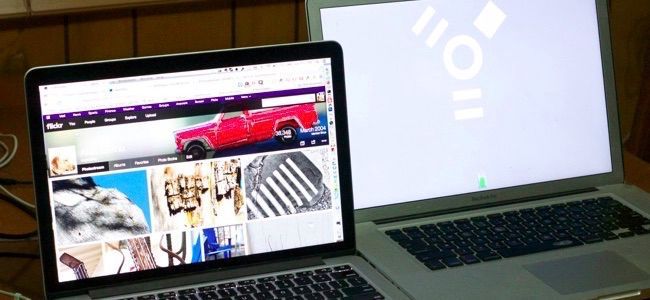

Assuming you do not have FileVault enabled on the iMac, connect a Thunderbolt cable between the Mac mini and the iMac and when you start the iMac, hold down the "T" key and that will automatically boot it into Target Disk Mode.

It sounds like pressing "T" at start-up forces Target Disk Mode. I am not sure when that kicks in (I am guessing sometime before macOS boot) so depending on how far your iMac can boot...
