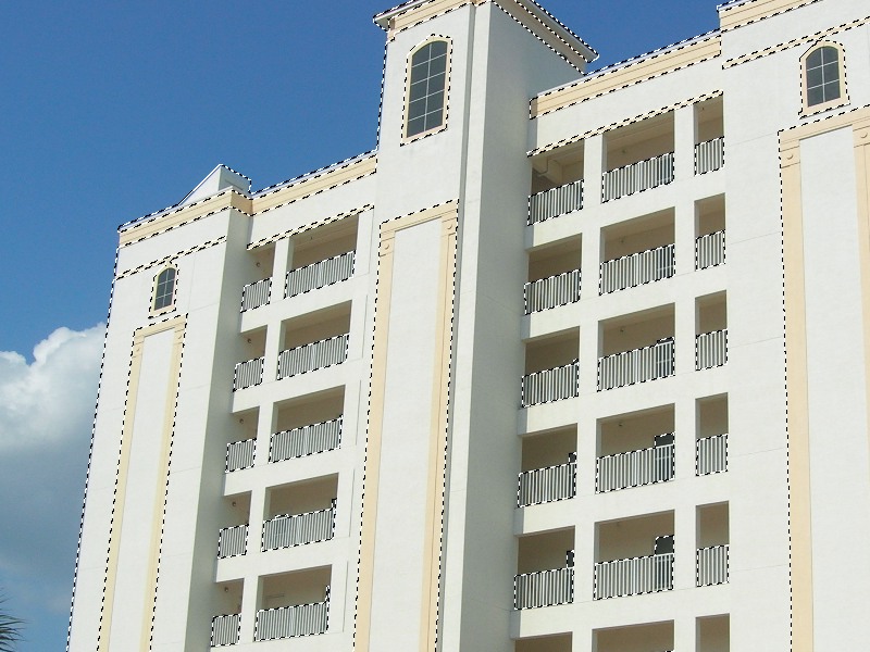

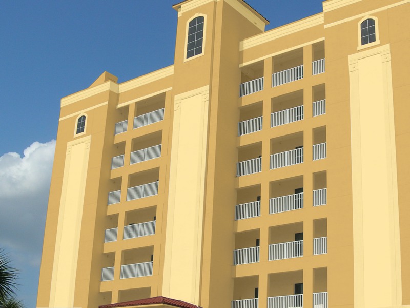

Attached to this post I have two images. One shows a building with a selection around specific areas, and the other shows what it looks like when I'm done replacing colors using Corel Photopaint. Getting from the original color to a target RGB with enough transparency can be a challenge (I actually match my printer's output to a paint chip). Anyways, Photopaint kills the target color with their replace tool unless the initial color is very close to the target.

Thanks for taking time to respond, Kwill. I adjusted the subject to clarify my question. My goal is to replace the color of the area that I've selected (usually a group of non-contiguous areas) with a target RGB which I've already predetermined to match an actual paint chip when printed on my HP printer.
In the past I would just use the Fill tool in Photopaint and adjust the level of transparency. The same as using the Paint Bucket with Opacity in PS. Before doing this I would always desaturate the selected area. Upon filling the desired color in with about 65% transparency I would be close - but there were always two very apparent problems. First of all, the addition of *any* opacity to the color applied to my selection would take away valuable information from the detail on the building below. Secondly, the more I would increase the transparency, the further off the color would be from my target RGB.
Ideally, I would be able to sample a color from my selection area then choose the target RGB, with all other areas in the selection falling into place depending on the level of light/shadow (see my attachments). This works pretty well using Photopaint's Replace Color tool (as opposed to the Fill tool described above), but when there are very dark areas - in the shadows for instance - the resulting color would be way off in those areas. It would not look like reality. Consequently I am relegated to using Photopaint's Color Balance sliders to get as close as I can to the target color, then doing the replace. A time consuming task. I just have this inclination that Photoshop could do this faster and better. I've yet to figure out how, though.
