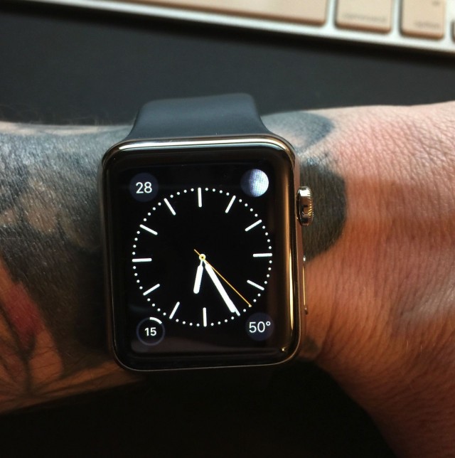

Interesting read, as someone who is heavily tattooed (sleeves all the way down to fingers) I'd like to know more, as I'm keen to buy one. I did a try-on appointment however all the watches I tried on were in "demo" mode so I couldn't really use them on my wrist. Can any Apple Watch owners with wrist tattoos confirm anything? Pics would be ideal to show your wrist tattoos if possible!

Not having a problem with mine. I was concerned because under the sensors my tattoos are red-orange and black, but wrist detection works as it should and heart rate monitoring seems okay as well.
But my tattoo isn't *solid* black.

I've got a small tattoo on my wrist and I was concerned before buying, it sits directly below the sensor and gives me no issues.

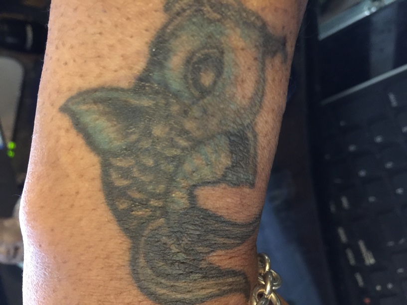

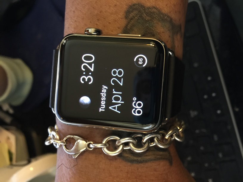

Argghhh
This took 2 days and 3 Apple techs to figure out, and the only way we figured it out was one guy in the support center had a watch. Just found out about this thread.
When you set up Apple pay on your watch it makes you have a password to open the watch. That's fine. When I would put my arm down every time it would ask for the password. That got old QUICK. It was okay when I didn't have the password but some other things were a bit glitch like the Watch going to sleep really fast. I also wasn't able to use glances or anything until I put in a password.
So to make a long story short, All this happened because I have a blue/green tattoo on the wrist I am wearing the watch on!!!!!
WTF???
It interferes with the watch in that regards. SO I now have to either not have Apple pay and wear the watch without the password on my tattoo wrist or switch to my non tattoo'd wrist to have everything work right. It will then only ask for the password if I take off the watch and works as normal and lets me do apple pay.
So now I told them and spread to word that if you have a tattoo on your watch wrist funny things may happen!
I'm glad its not sensitive to skin tone like it is tattoo's but I guess we would have to hear from someone very dark-skinned to see!
smh - btw I have the Watch, not sport, with the sapphire
crystal and the traditional black buckle
