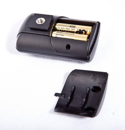

This is the receiver
So it looks like I can mount the flash on it, then screw the whole shebang onto the stand, without requiring a hotshoe adapter? Or would it be better to get the hot shoe adapter, then connect with the sync cord? In theory, that should not offer an increase in reliability, correct?
Yeah, that should work, though it's going to partially depend on how sturdily built the hotshoe on the cactus receivers are. I'd give it a shot.
