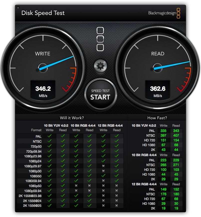

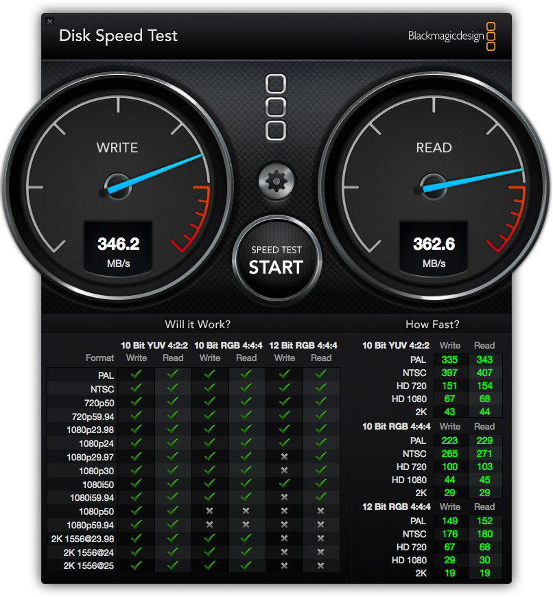

I'm running one with the OWC dual drive enclosure (the two come together as a kit) and it performs really well if you use as a raid (as stated above). Here is what I get from just two 1TB spinning hard drives:

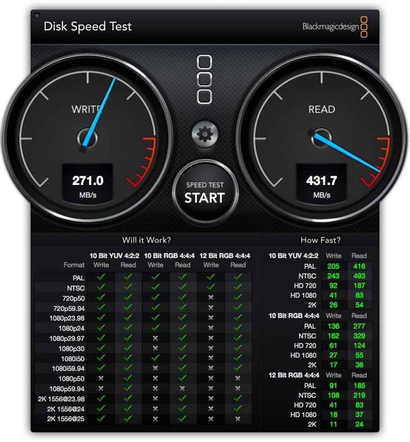

As a point of comparison, this is what i get from my internal SSD (Mercury 240 GB SSD)

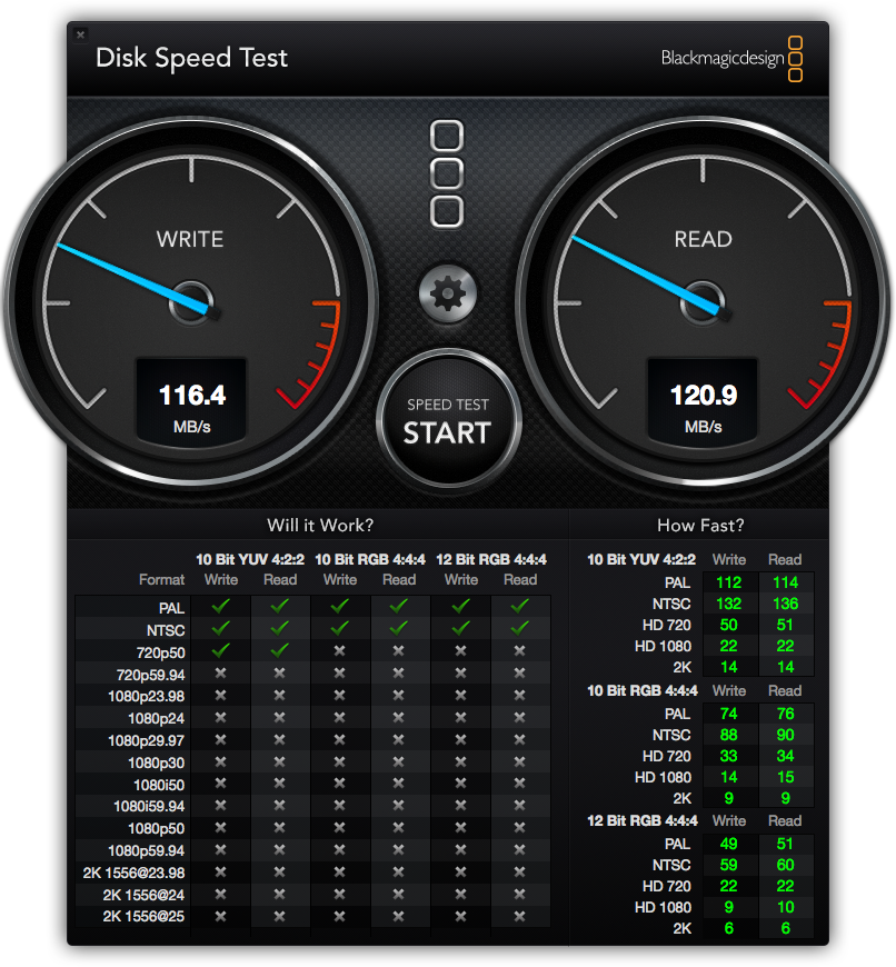

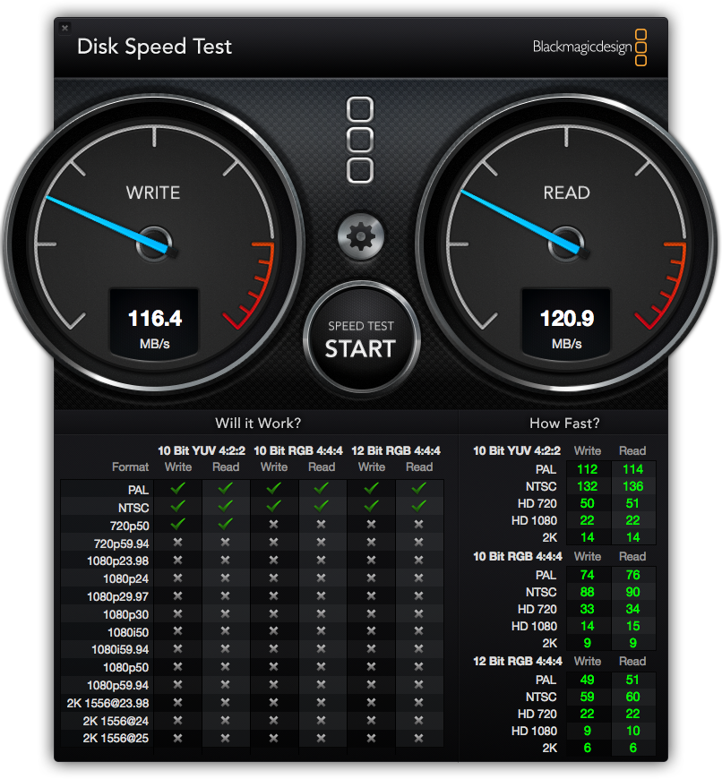

And finally, here are my numbers for the OEM spinning HDD that came with my iMac:

TB eSATA (Two 1 TB hdd with OSx raid 0): Write: 346 MB/s, Read: 362 MB/s
Mercury Elite 240 GB SSD (Internal SATA): Write: 271 MB/s, Read: 431.7 MB/s
Internal SSD (OEM): Write: 116 MB/s, Read: 120MB/s
Edited Internal SSD numbers, I had looked at the wrong screenshot
