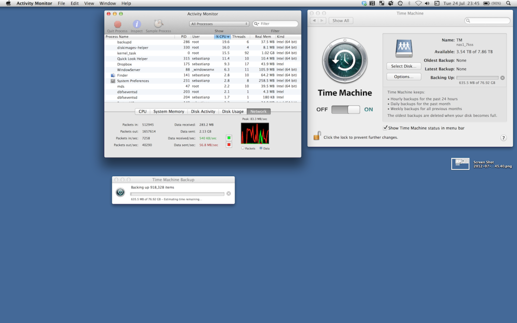

Hmmm. That is odd. What are you using to monitor the transfer rates?
Activity monitor is quick and dirty, however I can pull stats from the switch
This is trying to run a time machine backup with both devices on GigE links, extremely low rate of traffic:

:eek: I completely forgot about this. I shall definitely try it tonight. I am putting a remainder in. :)
Edit: It is now later tonight and I've tried it using my Synology DS1511+. I am watching it now and I am peaking at around 80 MB/s, but I only took a screenshot when it was 56 MB/s.
Edit: It is now later tonight and I've tried it using my Synology DS1511+. I watching it now and I am peaking at around 80 MB/s, but I only took a screenshot when it was 56 MB/s.
Thanks, good to know it's working with your NAS. I'll do some more tests with a direct file copy into a sparse bundle to see if I can recreate it without timemachine being involved... Regardless I guess it's time to submit that bug report (or buy a NAS)
