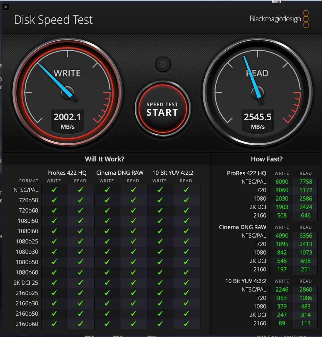

Some drives:
http://barefeats.com/hard232.html

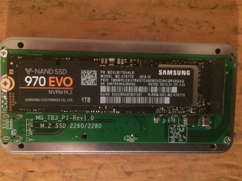

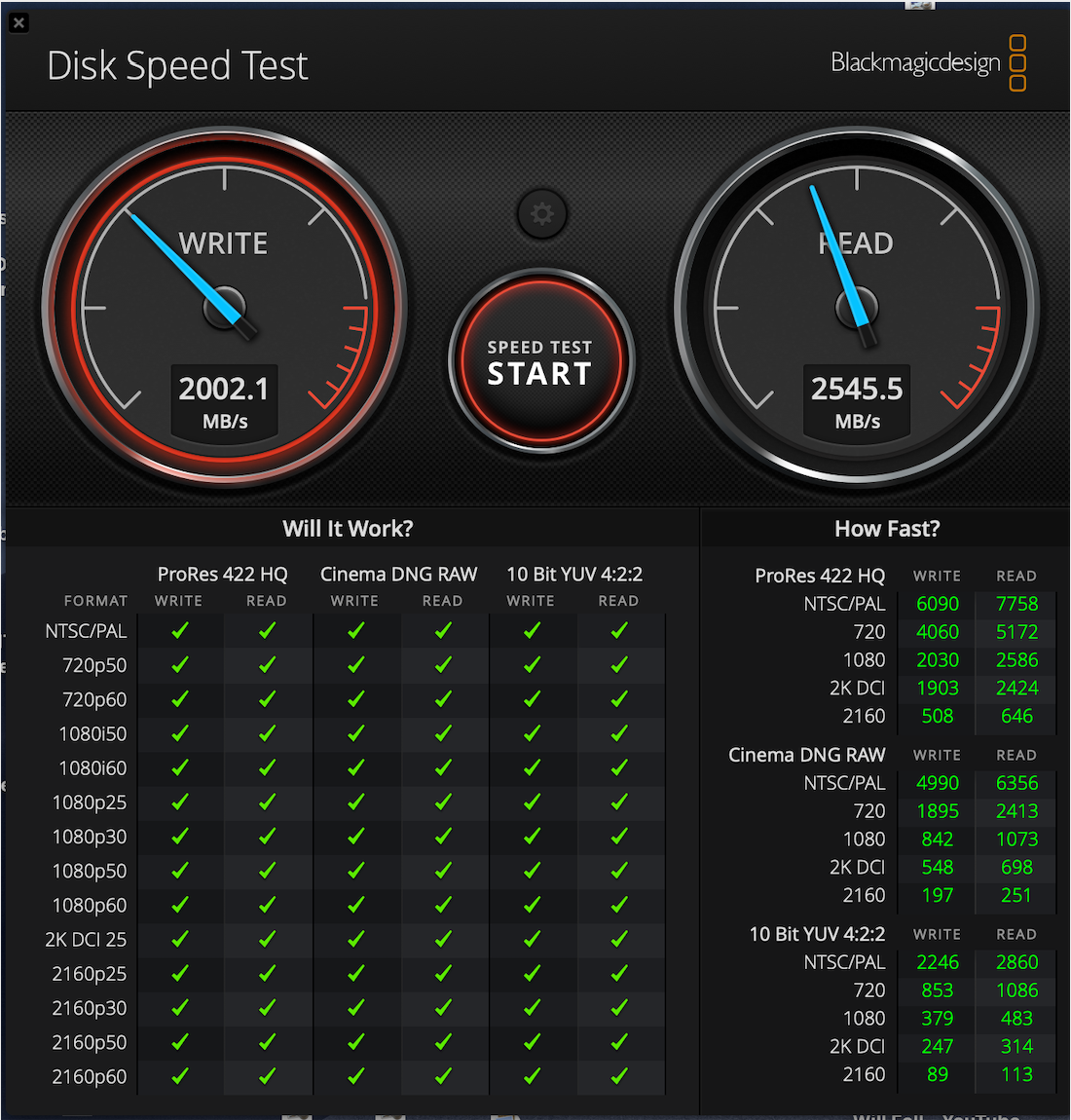

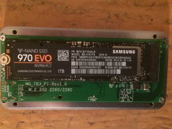

Leidian enclosure:
https://forums.macrumors.com/threads/leidian-m-2-to-thunderbolt-enclosure.2157774/
Reactions: Miat and F-Train

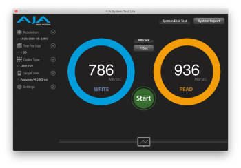

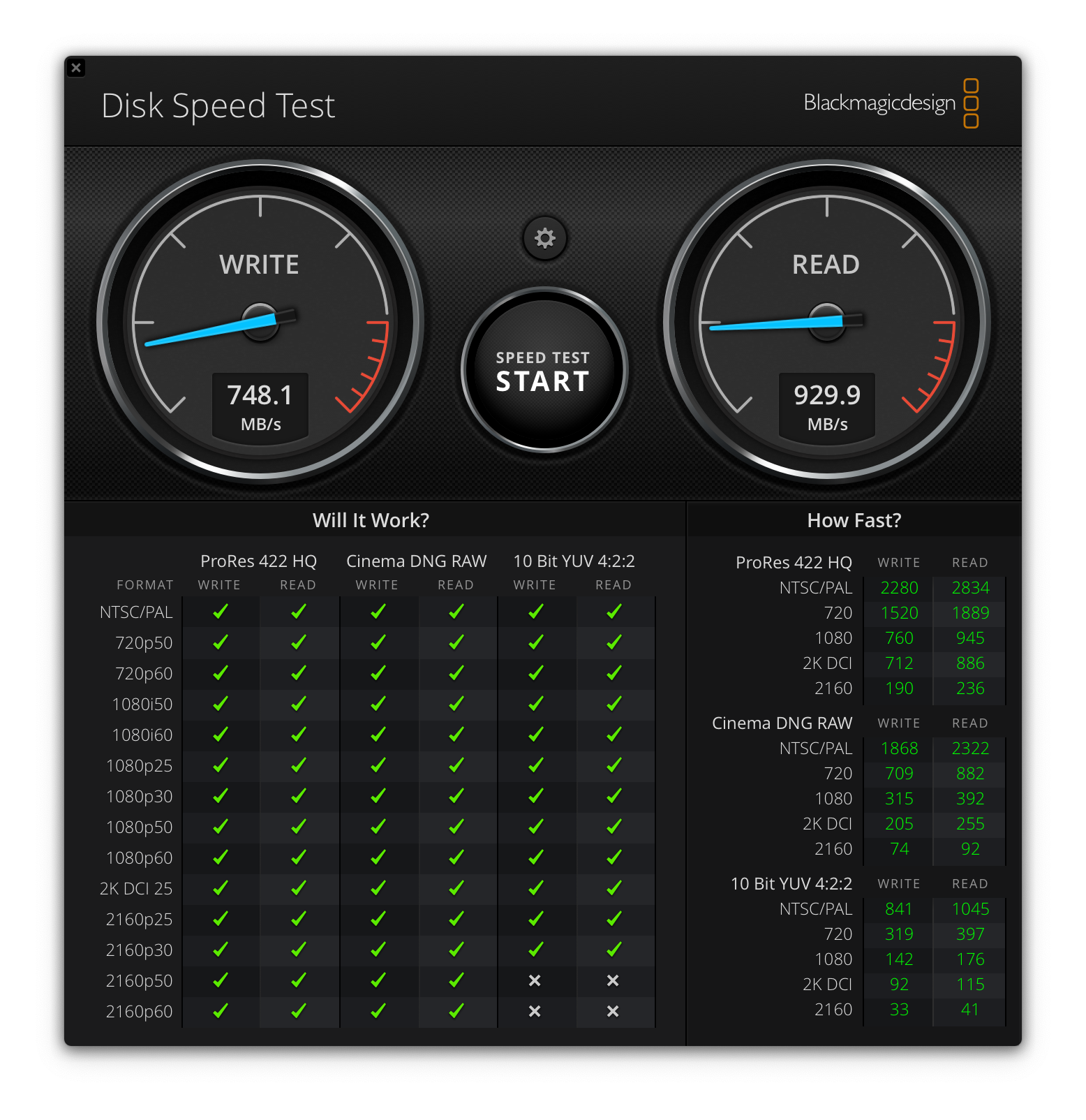

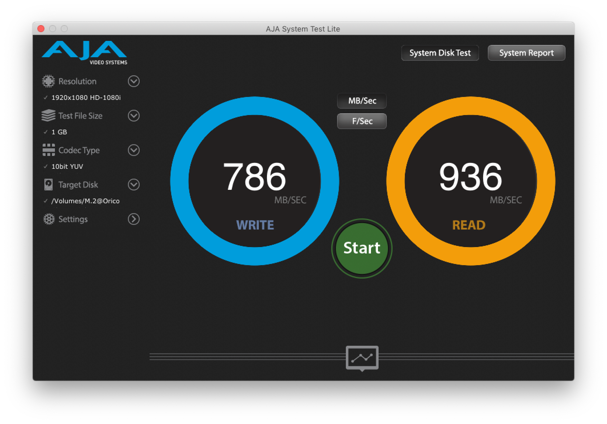

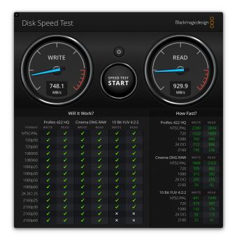

OK, so my new stuff arrived.
I've spent a lot of time this evening futzing around, because either these devices, or the cables, or the Mac mini are very particular about working together, and I think it's power related. If I have two bus-powered devices (e.g. two SSDs or an SSD an a TB3 to Dual DisplayPort adapter) on the same 'pair' of TB3 ports, invariably one of the SSDs fails in some way.
With the SATA SSD, it will mount, but then experience issues in operation (more so writes than reads, it seems), and eventually macOS will report it was disconnected.
With the new NVMe SSD, it won't even appear if it's on a pair with another bus powered device.

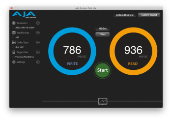

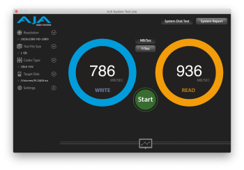

Anyway - so the NVMe in the USB-C case works pretty well - 700+ MB/sec write, just under 1GB/sec read.
Screen Shot 2018-12-08 at 22.54.14.png Screen Shot 2018-12-09 at 00.42.53.png
I'm copying my work drive (the SATA SSD) to it now using rsync, I'll try using it for work stuff (the taxing part is the VMs) for a few days and report back any issues I find.
