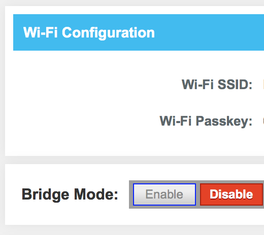

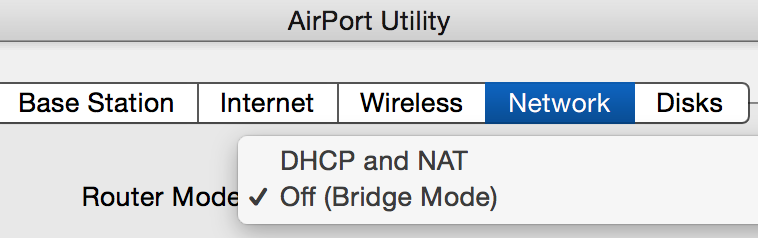

[doublepost=1542596968][/doublepost]on the subject of Bridge mode, I'm attaching screenshots on how my xfinity router and Airport base Station extrem are set up former is "off" and the latter is "on (i.e. the ABSE is on the network but not being as a router ( a shared disk drive and a "switch" - a'm I correct?) - thanks

You can't really use the TC to extend your WiFi signal. I believe you would need the combo of the Airport Base Station plus the cheaper Airport Extreme model in order to extend the WiFi signal. The TC and Xfinity Gateway being close to one another should not cause interference provided you're using one of them in Bridge Mode. And It appears you have them setup correctly from your diagrams above. (Xfinity Gateway in Bridge Mode)
Like I said above, Apple has gotten out of the wireless hardware business so if you can get hold of an Airport Extreme from QuickerTek that will extend your WiFi and it works okay, that might be the way to go. But for now, the way you have things set up looks okay as long as your TC stays healthy.
actually, I m pretty sure that my xfinity GATEWAY is not in bridge mode(Ie, its performing as a router and my TC is in bridge mode (performing as as "switch and network hard drive- unless I'm confused.
