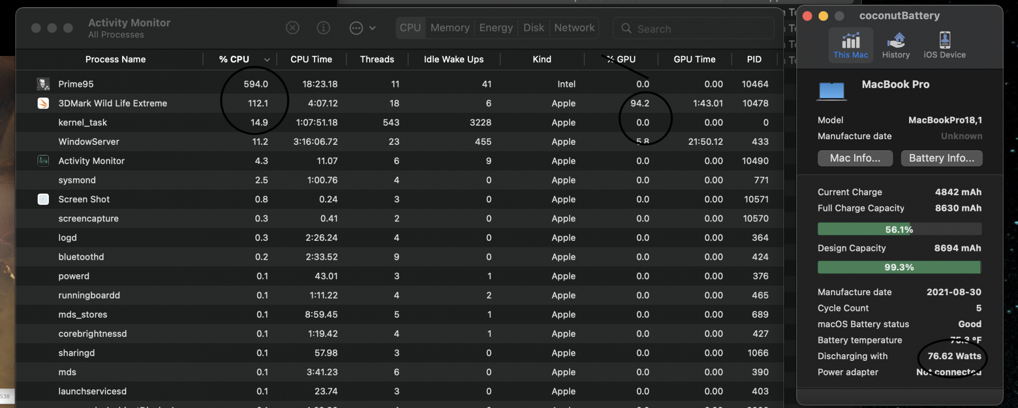

This is an 16 inch M1 Pro under load and at max brightness (SDR 500 nits, HDR would be more), so an M1 Max would use even more power. The 60W will not be enough to both run and charge the device. So it will discharge if you are pushing it to it's max but you would have to keep it under load for a long time to completely discharge it.

That's how I would assume it would work. Not ideal for long battery life in a desktop situation though, it'd be constantly depleting the battery (assuming you have often have workloads that need more than 60 watts).
