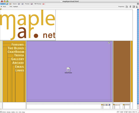

Arghhh!!! I decided to try and go through a tutorial in an Adobe Ideas book and try to apply the techniques to my own website.
I am totally stuck!! :'( 'All I want is for the purple box to change when you select one of the buttons on the left. Thats all.... I have put an iframe in place there but cant work out how to make it change when the links are pressed! I designed the site in Illustrator and sliced it - now I am working in GoLive.
All the links are external sites - like an invision forum board and xanga blogring. So all I need is that purple box to change to the xanga site when the blogs button is pressed etc.
Here is a screen shot :
Any help would be soooo appreciated - and may save me yet another migraine! 🙂
Thanks
Kat x

Did you set the target of the link to the iFrame? That should be all that is required.
And yes you need to use frames to do the page within a page thing.
I am going to sound incredibly thick but I cant get this to work. On the target drop down window, I have _self, _top, _parent and _blank. No iframe option there.
Its driving me nuts and any very basic help will be more than appreciated! 🙂
Kat x

Yup. It might be easier to do it in the source code...
If your purple box's frame name is "purple_box" then change your link to:
Code:
<a href="forum/" target="purple_box">Forum</a>
Hope that helps,
reality
If you want to do iFrames, the links on the left will look like this:
Say you named the iFrame "main":
<a href="home.html" target="main"><img border="0" src="image.ext"></a>
Hope that helps. If you only have choices, like _self, _blank, just type in "main" and it should let you do that.

Right, he has image links, though so instead of "Forum" it will have an image tag like
Code:
and then the
Code:
</a>
Another thing to remember, is that it won't usually work inside your HTML editor, you're going to need to upload it and test it, or open it in Safari.
I would really recommend the PHP navigation method, as iFrames are often looked down upon as unprofessional. If it's just a personal site though, it's ok to use them.
Thanks guys! 🙂 Got the iframe bit to work in the end.. I will keep all these notes for the future as I am learning all the time. I opened the site prematurely as I didn't think it would do very well - but it has, so I am always in a rush to learn and complete the next thing - with absolutely no experience at all!😱
