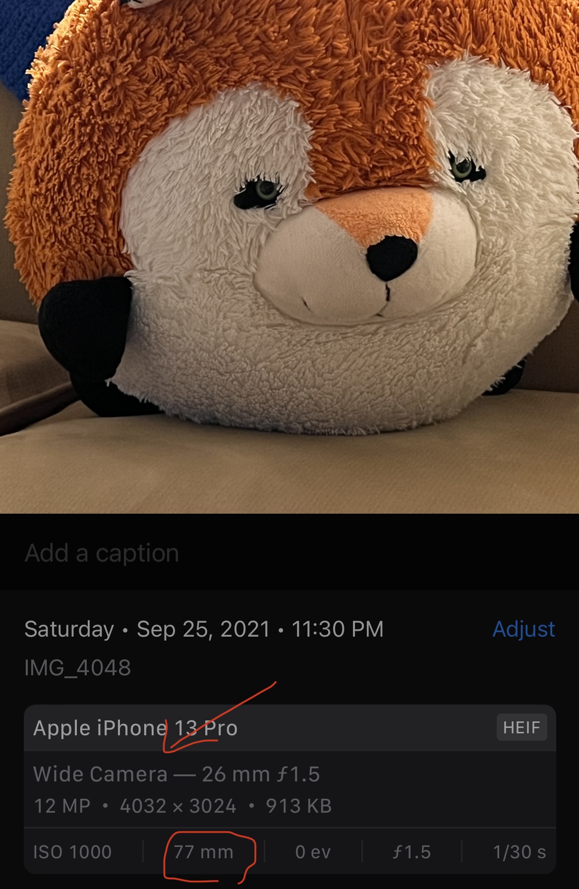

It goes back and forth depending on the lighting. Sometimes it shoots properly, other times it switches to the wide and crops. There really should be a way to force the lens to stick.
Here’s an example. Low indoor light but not quite enough for night mode to kick in. I had it set to 3x and the exif data shows the proper focal length as 77mm, but the lens info indicates that the wide angle was used.

I think it's a combination of lighting and focus distance based on my test. Or maybe it's entirely due to focus distance in the end because the autofocus will inherently be worse in low light. I did notice the phone jumping between telephoto and main camera and back even when holding the phone still, which makes me think the telephoto was figuring out its autofocus in those fractions of a second.
I think this is basically just an extension of the macro auto-switching "feature" that has upset some camera people. If the phone thinks something is too close for the camera to focus on, the phone will try to switch to the next lens and attempt a crop for framing purposes.
