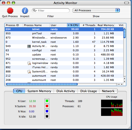

Like the title says, then it takes up about 95% of one core of my processor!
Anyone know why? its about the 5th time its done it...

Telnet (incoming) is off by default on Mac OS X, are your sure you haven't turned it on?
Here's Apple's documentation about enabling Telnet access.
But using Telnet as a "client" is on. Sometimes you can use Telnet to configure your DSL modem, or network printers etc.
Maybe some software you have installed uses Telnet to connect to some network device...?
Strange. If it were a backdoor on your Mac, the process would show as telnetd (the telnet server) rather than telnet. It worries me that this may be a process calling itself telnet, but not actually be the OSX telnet client. The built-in one should never get up to those CPU cycle levels.

Mmm, it *is* strange. What do you have running on this Mac? The telnet process looks like it's owned by *YOU* in the first picture.... not that it couldn't be someone hacking you, but that seems unlikely. More likely is that you have some program or something that is launching a script periodically, and the telnet task is being invoked for some weird reason to act the script out.
