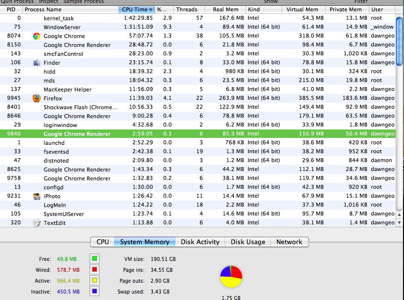

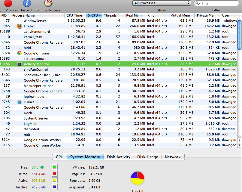

ok here's screenshots....
thanks

in the far right PID...I have no idea what most of what's listed there is....I'm certain that I could quit several processes but since I have absolutely NO CLUE as to what I'm doing, I just leave it, rather leave it than quitting something that's really important.....
can you advise me on any of what I can quit without it being detrimental to the computer????

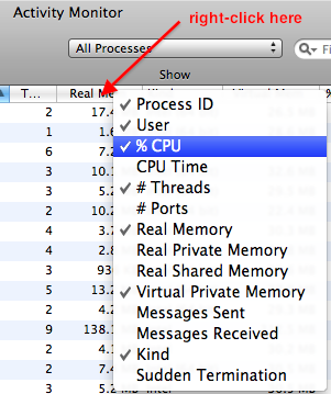

Click on the CPU column heading once or twice, so the arrow points downward (highest values on top)
I don't have a CPU column at the top, I do have process name column that I can click on to change the arrow?????
Right-click on the column headings and check "% CPU". If it's already checked, resize your columns or scroll to the right to find it.

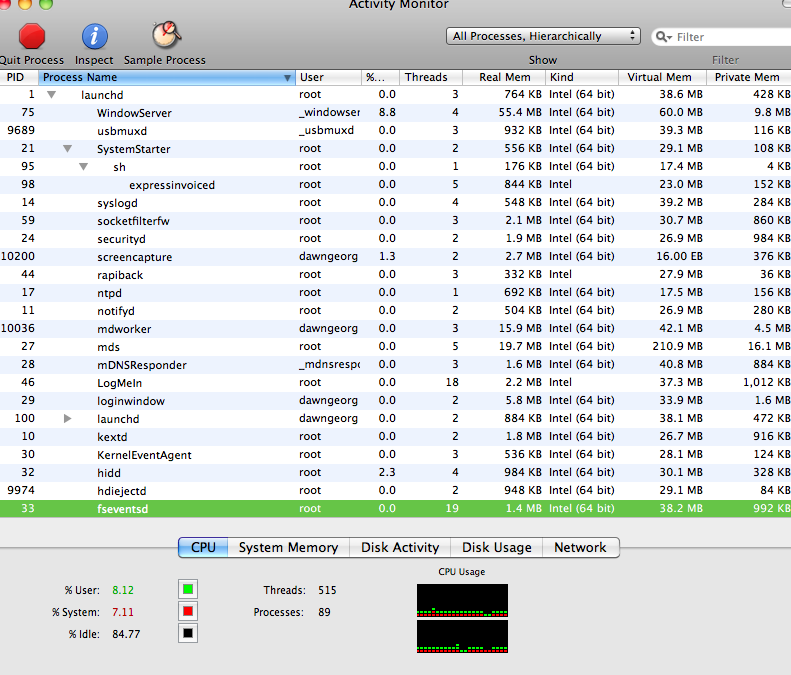

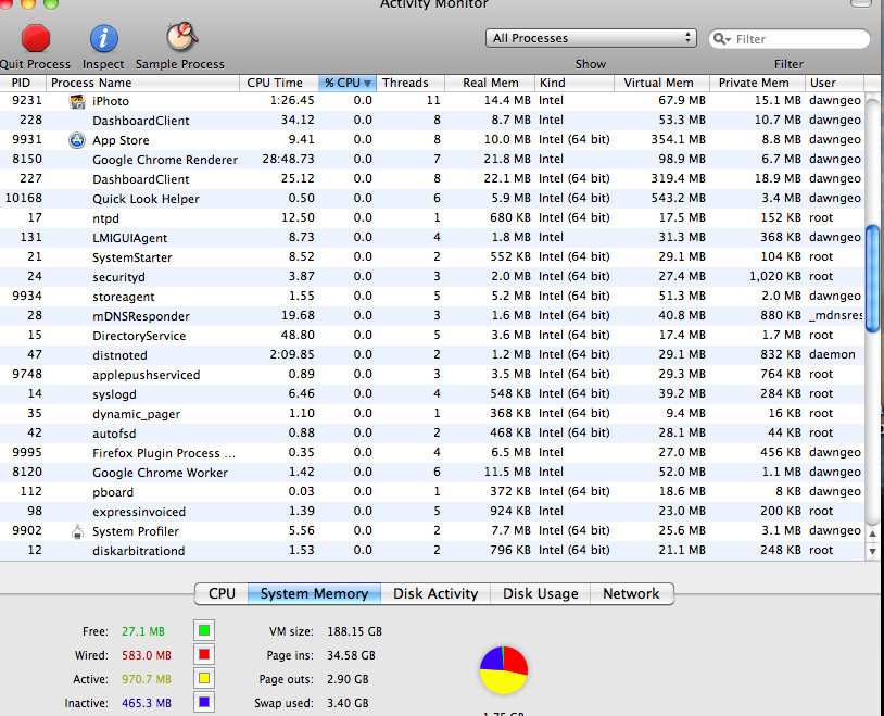

ok let me try this again....
4 screenshots
4 screenshots
This will go better if you follow my instructions exactly. They are very precise. I didn't say "CPU Time". I said "% CPU". Note the image in my post. It has "% CPU" checked and highlighted, but "CPU Time" is not checked or highlighted. It should look exactly like this:

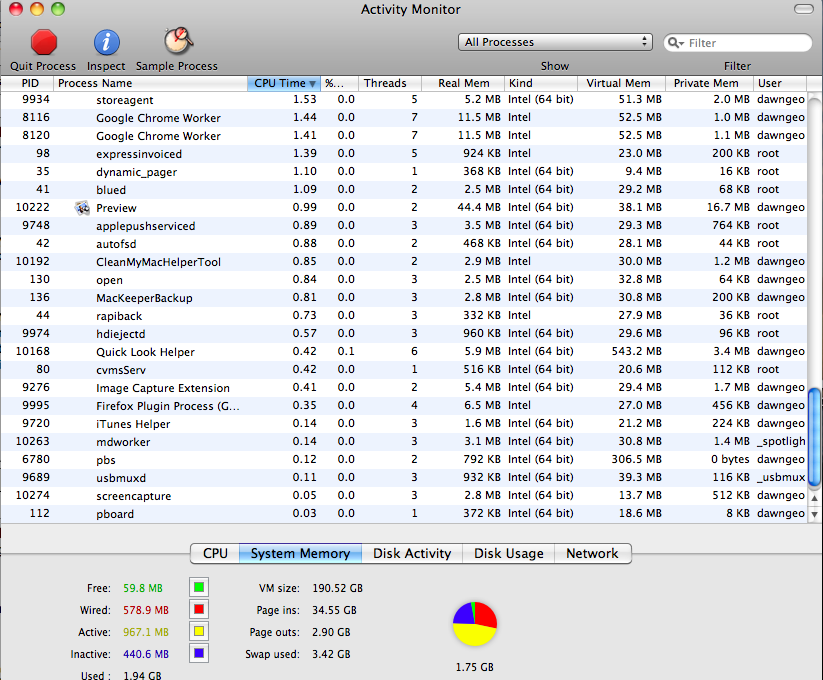

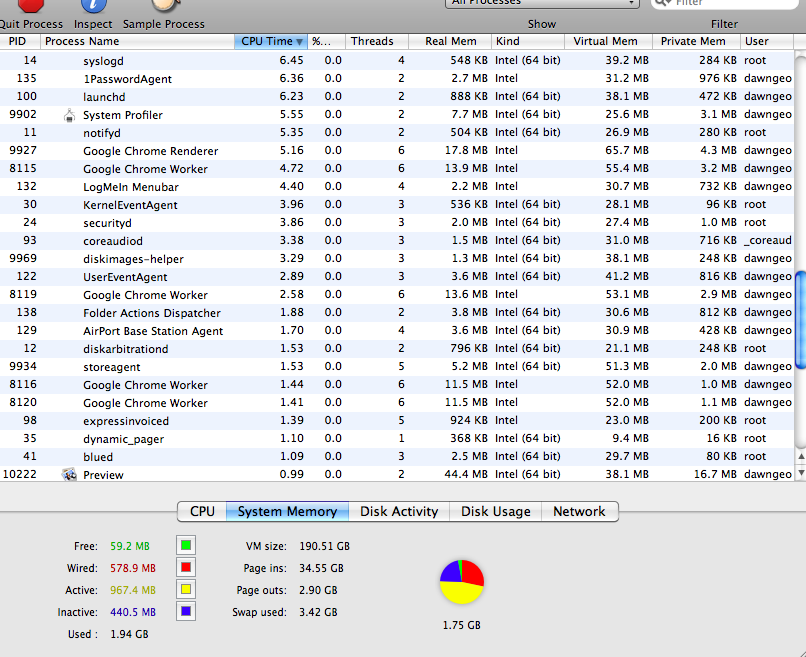

ok sorry, now I see what you were talking abt....... hope i did it right here ya go

MUCH better! Thanks! There are two things I see.
First, I highly recommend that you uninstall MacKeeper. You don't need it and it can do more harm than good. The most effective method for complete app removal is manual deletion:
Second, you're using Flash. As I said before, read the information about Flash near the bottom of my first post.
I also see you have some page outs. After you uninstall MacKeeper, restart your computer to reset your page outs to zero and track page outs under your normal workload (the apps, browser pages and documents you normally would have open). If your page outs are significant (say 1GB or more) under normal use, you may benefit from more RAM.
