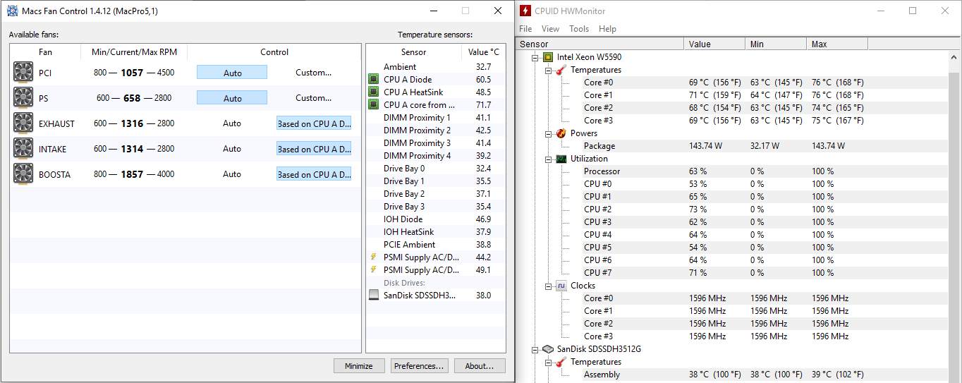

Just a quick question regarding the temps on my 4,1 under windows. MacsFanControl shows a lower cpu diode temp than HW monitor (and corsair's monitor) where they show different temps. I don't remember these two being different, but they are now at least. Which one should I be looking at?

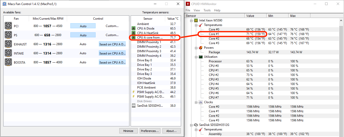

It looks like HWMonitor can only display the “core to PCECI”. And MFC only display the highest "core to PCECI". Which both software unable to make it meaningful.
By comparing the heatsink temperature, and ambient temperature. The CPU diode temperature in MFC seems the more correct reading.
If in doubt, check the delta temperature between the CPU diode and heatsink in macOS. Then you should have better idea which one is the correct one in Windows.
