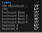

These days I have 65-67°C idle temperature according to iStat.
