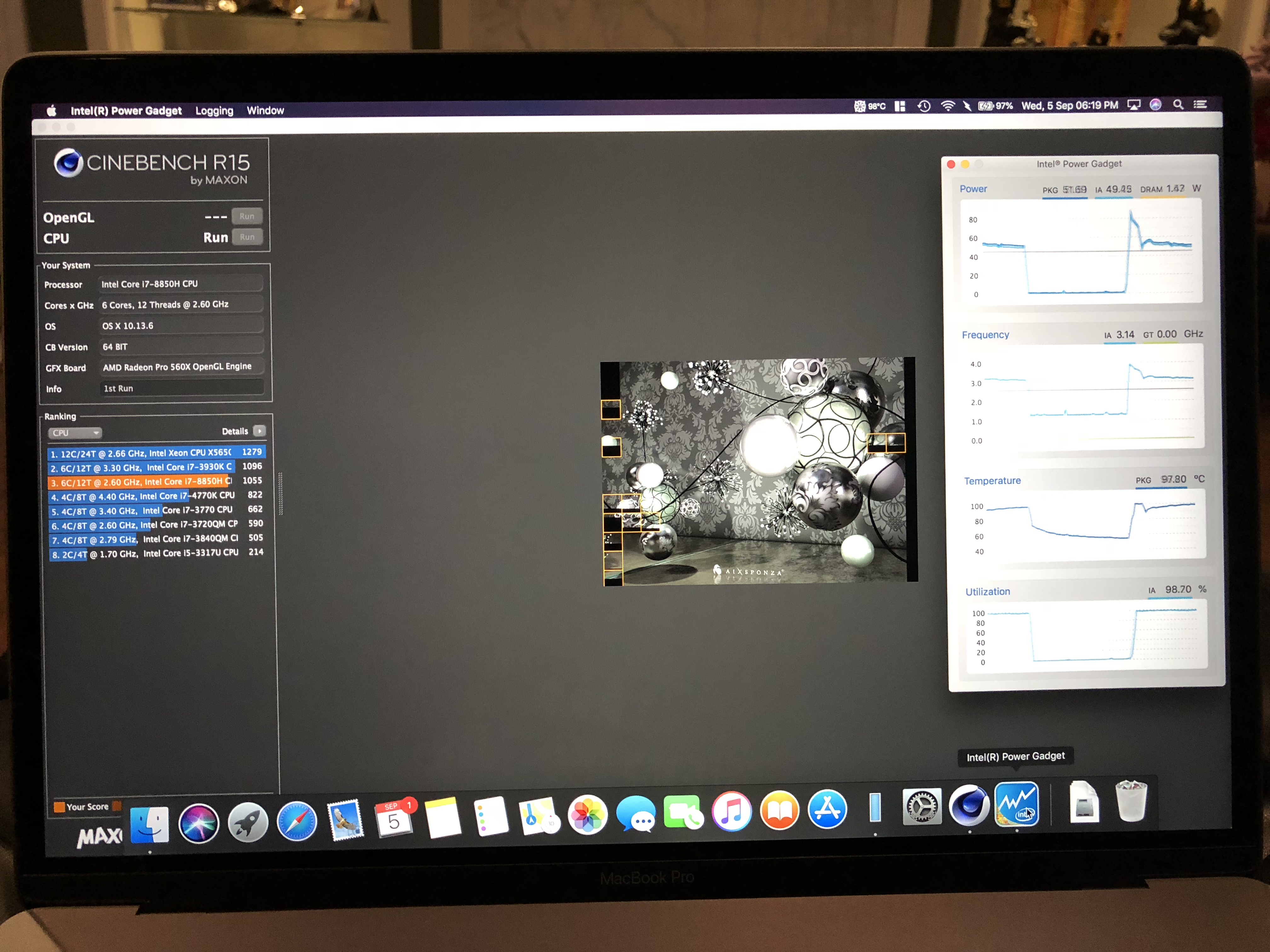

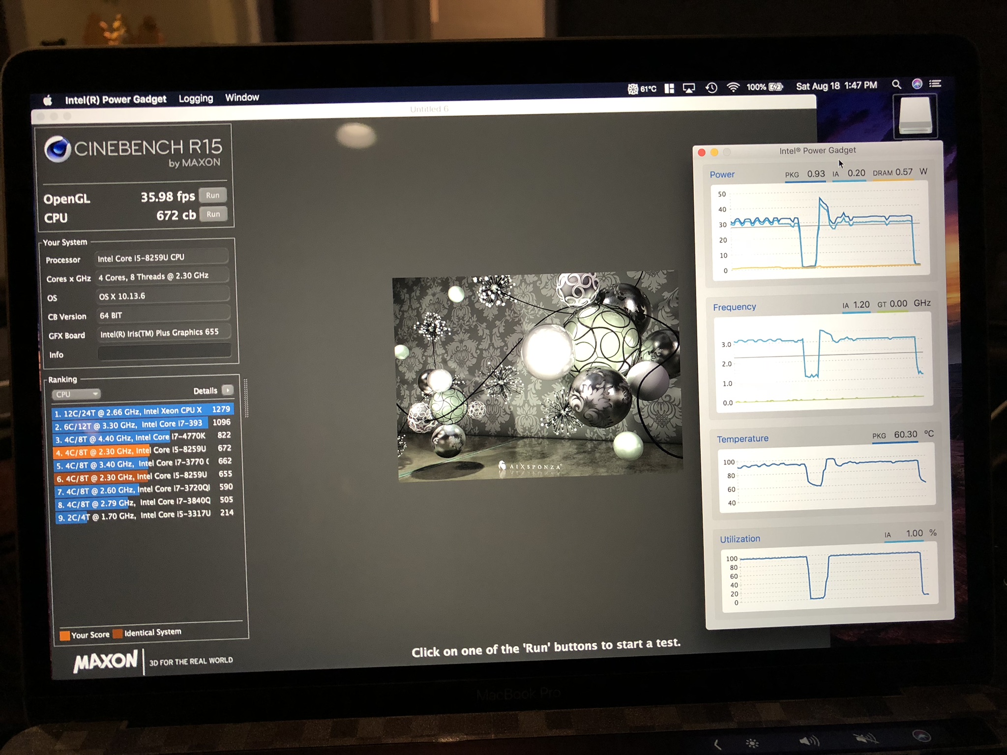

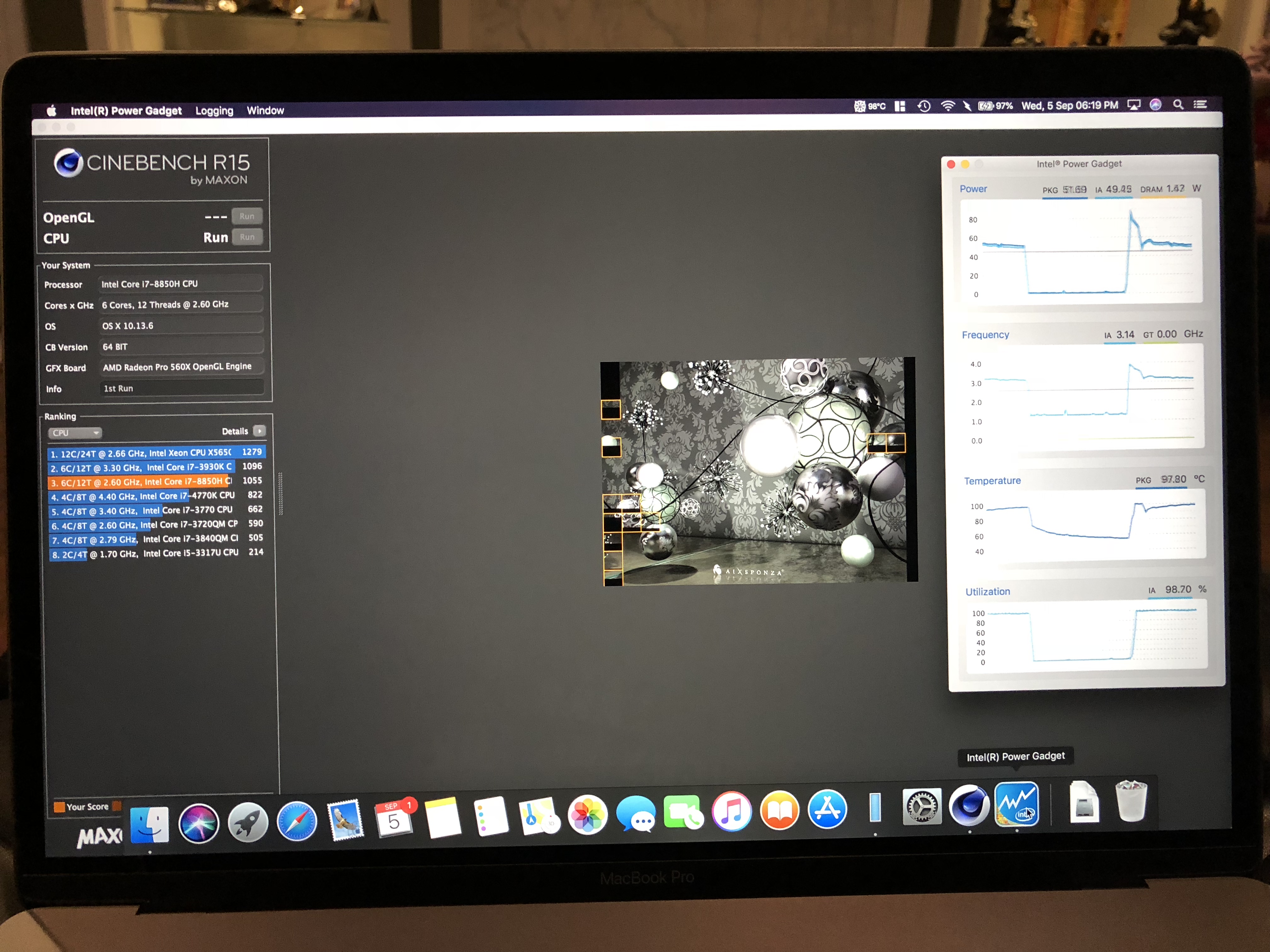

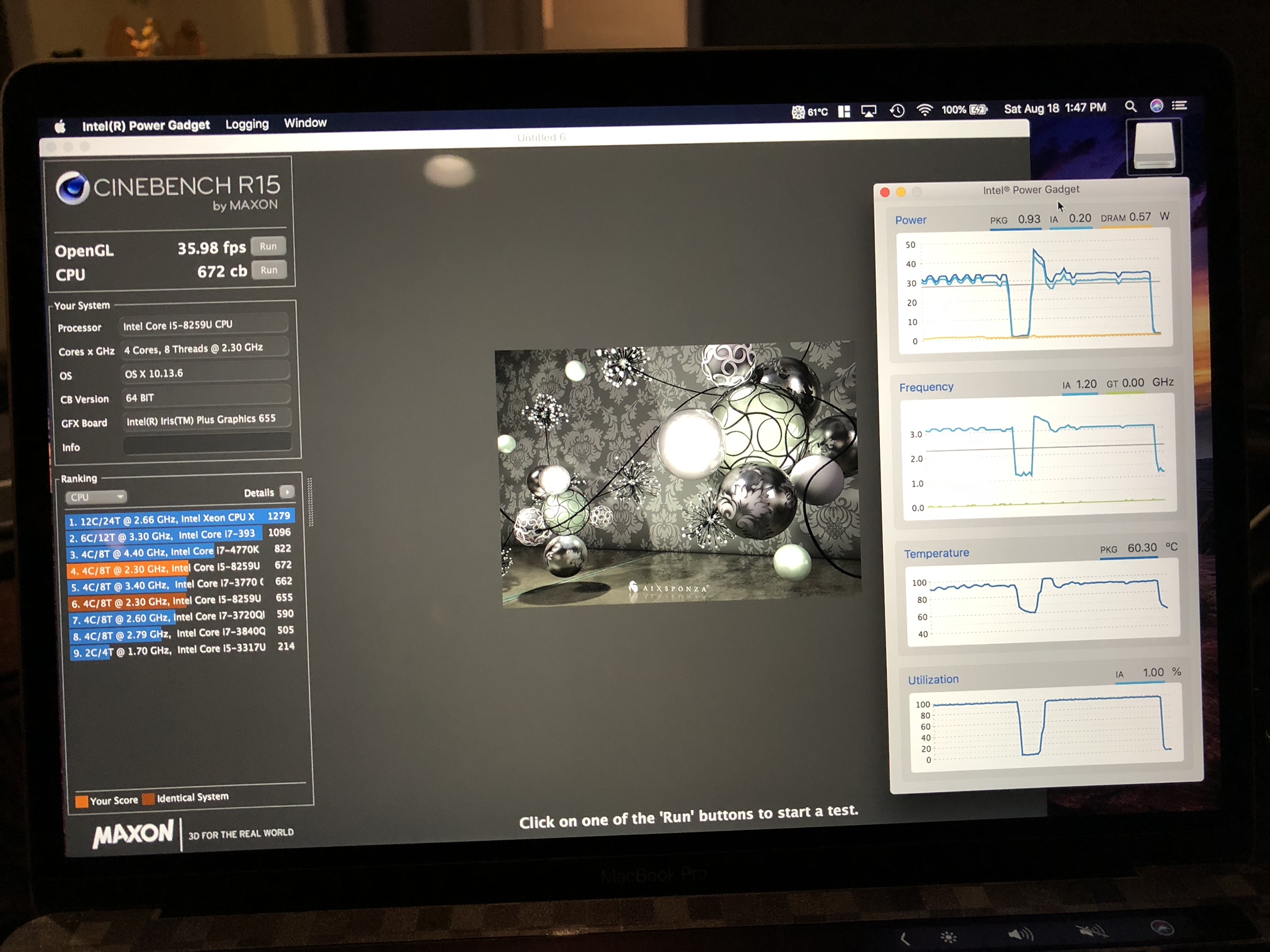

48AF6B42-6F68-4851-A322-0C201055E2AC.jpeg 74A1A0E6-29C3-4FF9-8872-31382ABC0E44.jpeg Having owned both 2018 models, the 13” i5/512/8 and my current 15” 2.6/512/16/560x, at idle, the 13” runs a few degrees cooler (about 40C). The 15” sits about 43C. Under load, both machines hit around 93-98C. Remember the 15” is pushing 2 additional cores as well as 4 additional hyper threaded cores, faster DDR2400 memory as well, along with the deification CPU when needed (the 13” integrated graphics is higher end than the integrated 15” graphics).
