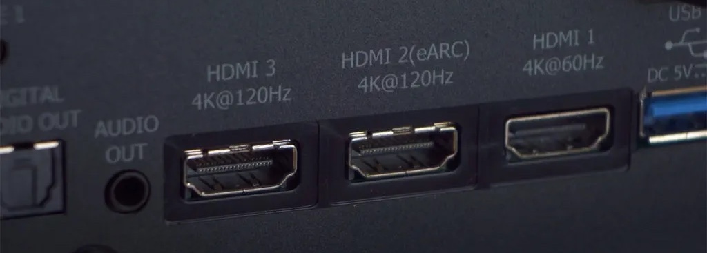

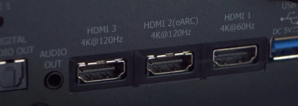

  • Soundbar shouldn't be plugged into any HDMI jack but one marked Arc or eARC. For example, in this setup, soundbar must be connected to HDMI2 (eARC) jack (your ARC or eARC may be on a different HDMI jack)...
