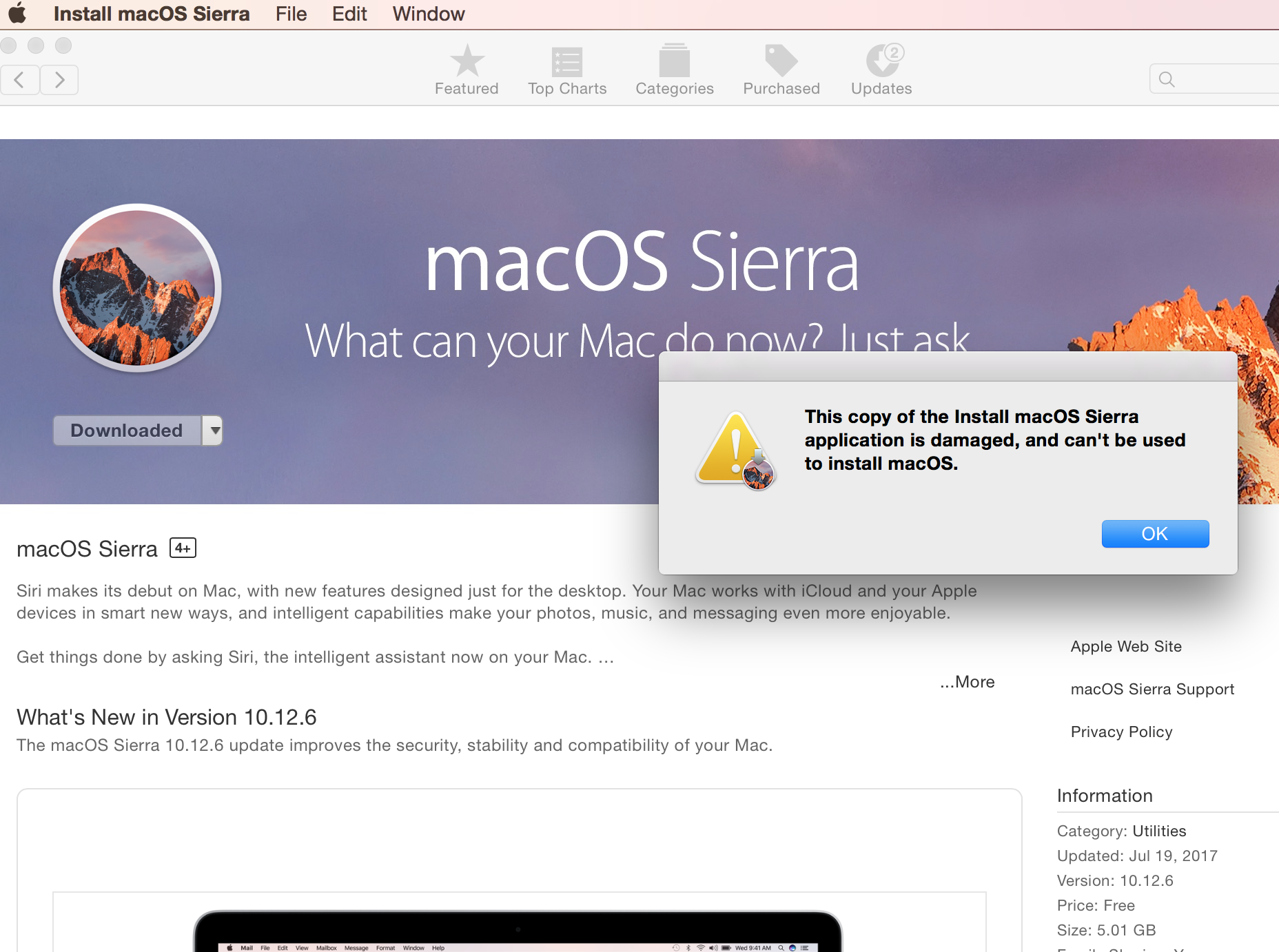

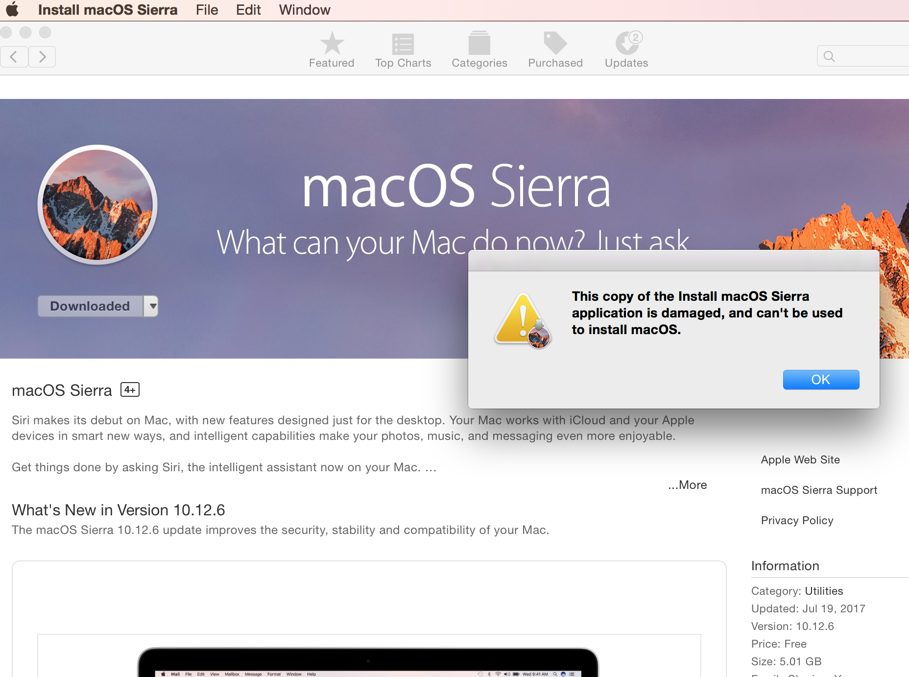

I just did a test using the link posted above:
to a Yosemite booted external. It downloads the full Sierra installer app. The installer automatically launches after download and I get the damaged error:
So it appears to me, that the full installer from the App Store still has a expired certificate.
Downloading the InstallOS.dmg does work, but Sierra installer can not be used to make a bootable USB installer, but it can be used to install Sierra when the InstallOS.pkg (in the InstallOS.dmg) is run it creates a Sierra installer (Install macOS Sierra) that can be run from the Applications folder, but can not be used to create a USB installer.
